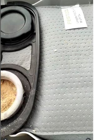

There's been many times with my ad-hoc Midi I've had to empty a solid brick as the unit just stopped moving sawdust being completely full, but the suction was still going, quite amazing how well they still work when full.

In my SR5E I'm using one of the pack of 5 original paper bags that I've sliced the end open and fitted a clamp so they can be emptied and re-used, many, many, many times!
But in the CT36 which mainly gets wood shavings and a real lot of MDF dust it's the long life, and in the Midi which I use for just about everything it's the longlife as well. My prior post shows the long life completely bricked.
Once they get full, they still keep on sucking up dust and actually really start to compact it all, so it's hard as a rock on the outside!
The other cheap dusties you can instantly tell when they're getting close to full as the suction completely drops off and the noise gets incredibly loud, not so easy to tell with the Festool's.
Once they (Festool) get full, they still keep on sucking up dust and actually really start to compact it all, so it's hard as a rock on the outside!

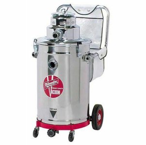

That's been my experience as well. The Festool vacs I own CT 22, CT 36 AC, MIDI, MIDI I & MINI I will all continue to run and will literally "brick" the dust bag, The old Milwaukee stainless 8925 will also brick the bag but then again it will also suck the chrome off of a bumper. :)
My old Shop Vac and Fein vacs gave up the ghost long before they bricked the bags.
