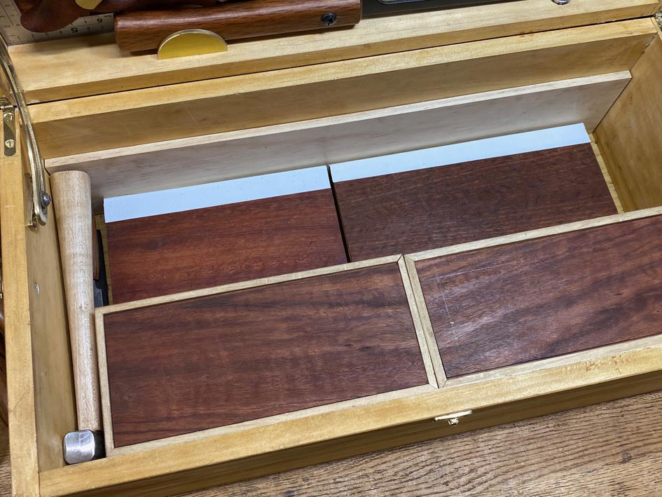

There are two boxes at the bottom of the chest ...

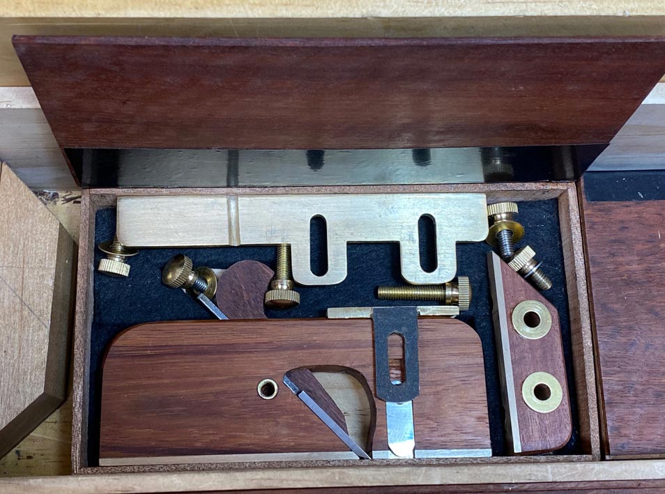

The one on the left contains the moving fillester/shoulder plane, which was posted some weeks ago ...
The one on the right has not yet been opened.

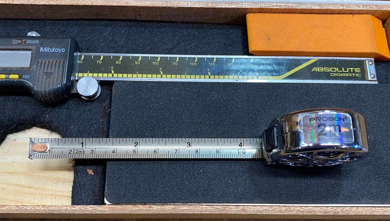

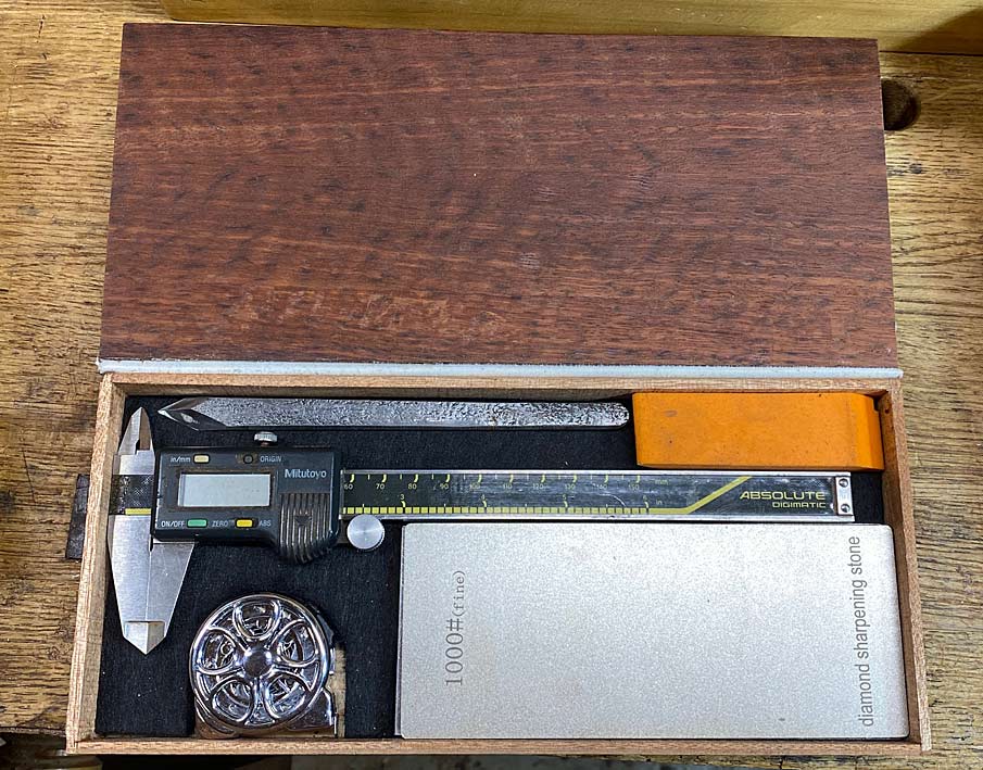

A digital vernier caliper is on the tool list and I have a spare Mitutoyo available. This one is 14 years old and still as accurate and as reliable as can be, and the battery lasts several months.

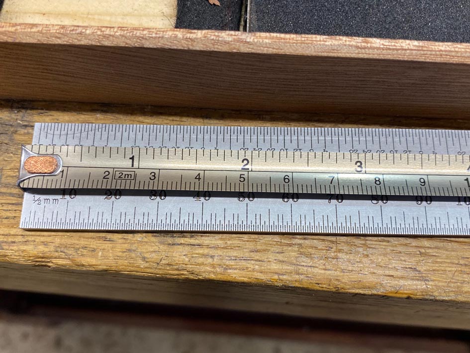

Tape measures are for roughing out. They are not precision tools. Nevertheless, they need to be accurate, and if you have more than one tape measure, they need to align with each other and a reliable scale. I have a few excellent tapes, from Starrett, BMI, and Hultafors, but they were all too large to fit in this box. I hunted around for a small tape measure, which needed to be both Metric and Imperial, and 2-3m in length. I found this one on Temu, just 40mm across. Intended as a kew ring, the blade is stainless steel and stiff. All for around $5!
It is spot-on accurate with a Starrett 300mm blade. Ignore the error of parallax in the photo ...

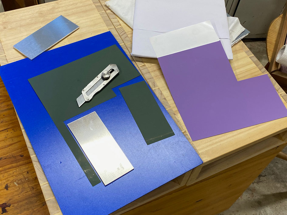

Into the box is a complete sharpening system capable of honing any blade you wish to throw at it. And cheap as chips! From Temu again ...

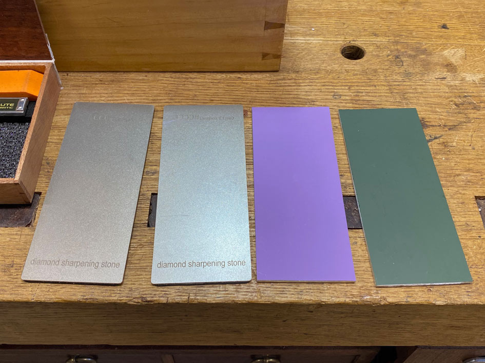

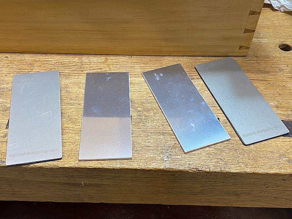

I had previously shown two 6" x 2 1/2" diamond plates, one 1000 grit and another 3000 grit. These were joined by two plates made of 5mm perspex with 12000 grit diamond mesh and 60000 grit chromium oxide.
However I was unhappy with the perspex bases as they flexed. These have been changed for 3mm aluminium plate. The aluminium plate was purchased online and sliced up on the tablesaw ...
Creating ...
These are large enough for my needs as I freehand hone. The orange eraser is for cleaning the media.

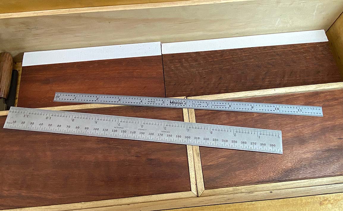

There are two scales/rules included in this tool box. One is a 12"/300mm blade for a Starrett combination square, and the other is a thin and flexible Mitutoyo, which is the best way to mark on curved surfaces ...
These are secured with rare earth magnets under the rim of the lid. Easy to access ...

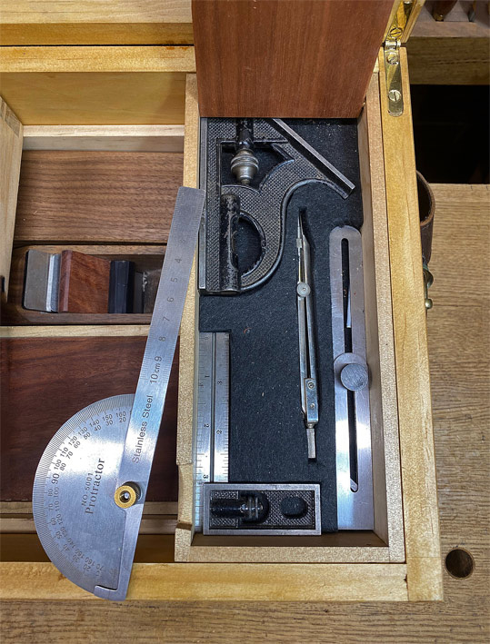

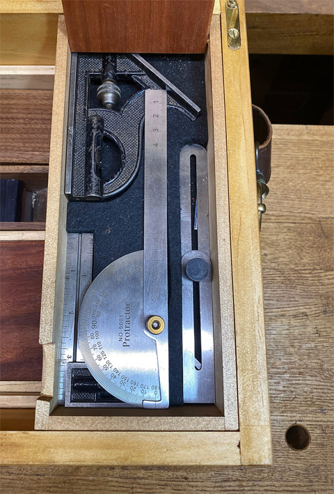

The other marking tools are housed in a box in the top row ...
Base for the large Starrett combination square, a 4" Starrett combination square, iGaging sliding bevel (looks to be a copy of a Starrett), a drafting compass which doubles as a divider, and a cheap but accurate ss protractor used to set the sliding bevel.
Can anyone see anything missing?
@derekcohen How about a small Shinwa carpenters square with one or a few of these stoppers:
These are available for various widths. There is also a very handy and in my opinion very precise accessory for the more sturdy Japanese squares that makes them function as an alternative for the western style combi square:
Bert, I have a couple of those in my workshop, and they are handy tools. However, for the tool box, space and weight is at a premium, and so some tools are a luxury. This task can be done with a double square or combination square.
