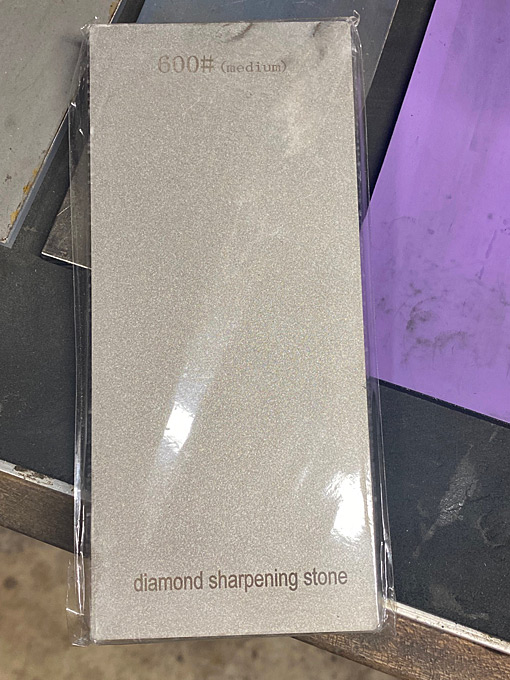

For the past year I have been researching diamond plates, and it has been an interesting and rewarding journey. My experience over about 25 years has been Eze-Lap, Atoma and DMT. Excellent, but heavy (an Eze-lap plate is 730gm or 24oz). Then I discovered diamond stones on Temu. These are no longer the poorly made diamond stones of even 5 years ago. I have purchased and used a number over several months, and they have all been of excellent quality to my eye, worked consistently well .. and cheap, so cheap (about AUD $7 each)!
175gm (6.2oz) for 170x75mm (6 3/4"x3") plate ...
Thin aluminium plate with a thickish rubber backing ... which makes them Light ...

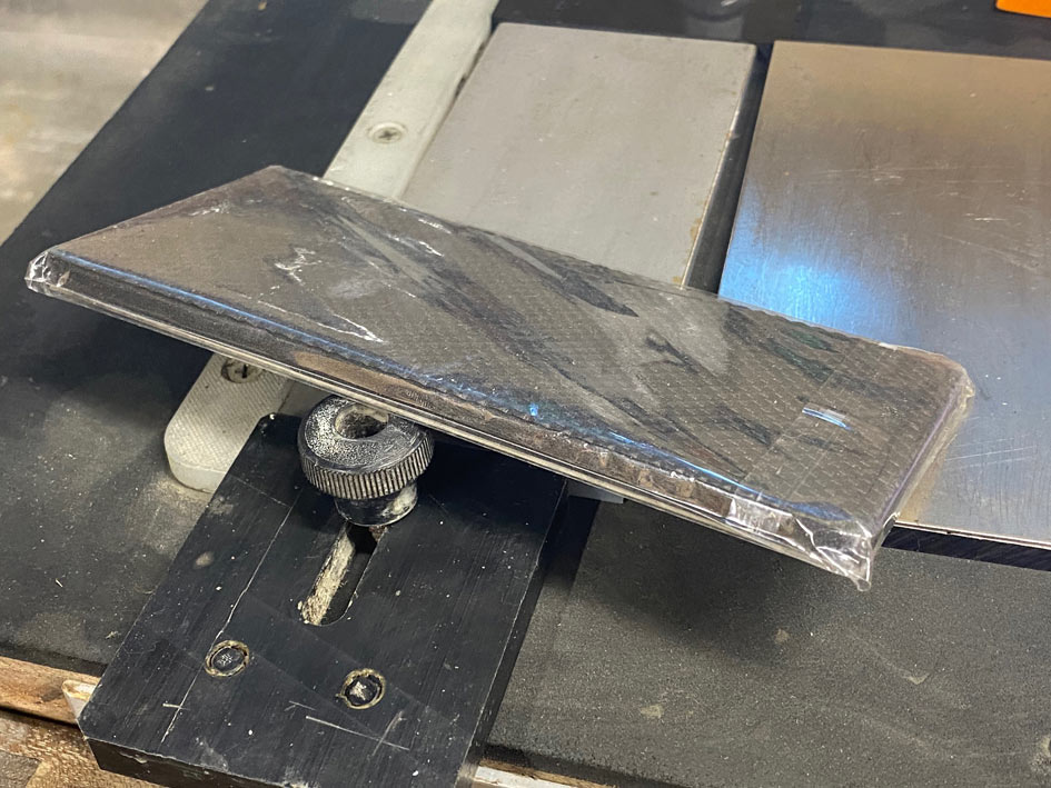

My advice is to scrape it off (A sharp chisel works nicely). The reason is that the rubber is soft and permits the thin aluminium plate to bend. I replaced this with a thin UHMW cutting board. Eventually, I settled on 5mm thick persex, which is lighter and stiffer ...

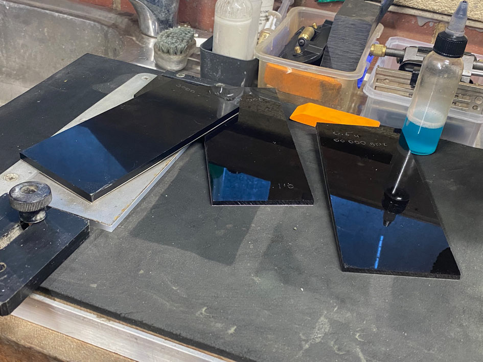

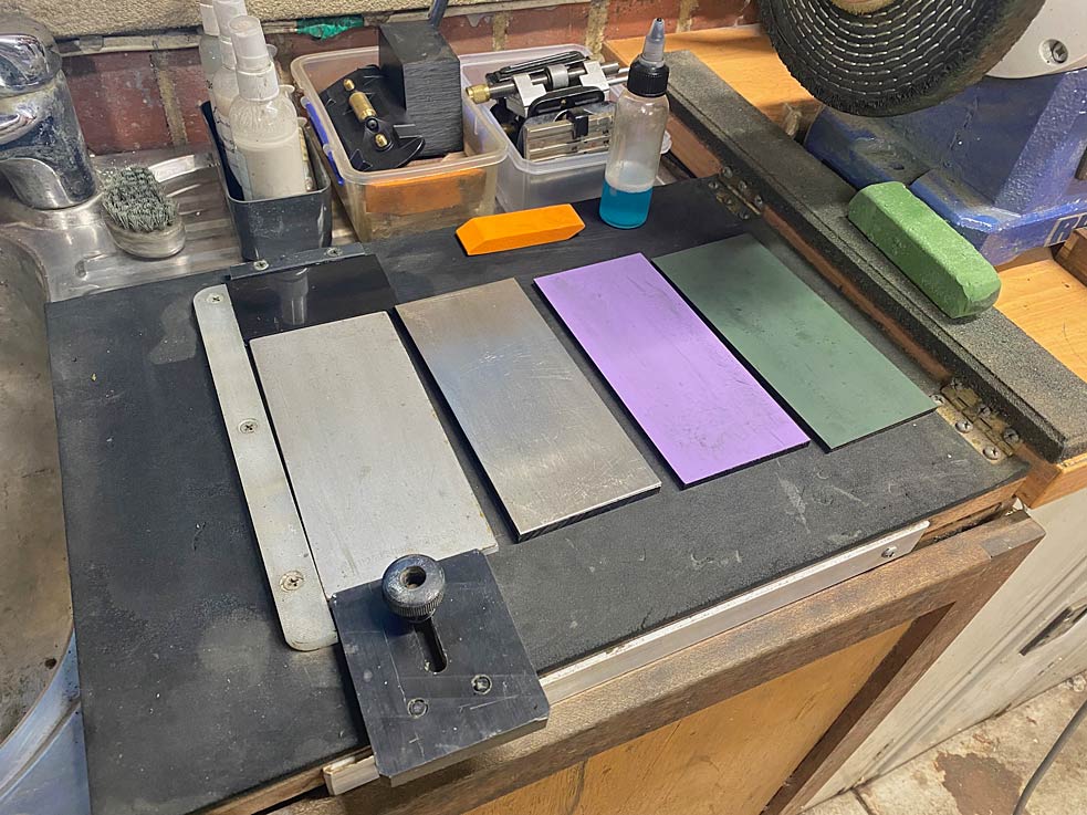

The diamond stones used are a 1200 grit and 3000 grit, which is as high as these go. Added is 1 micron (14000 grit) PSA Diamond Lapping Film, and 0.5 micron (60000 grit), all attached to 5mm perspex .

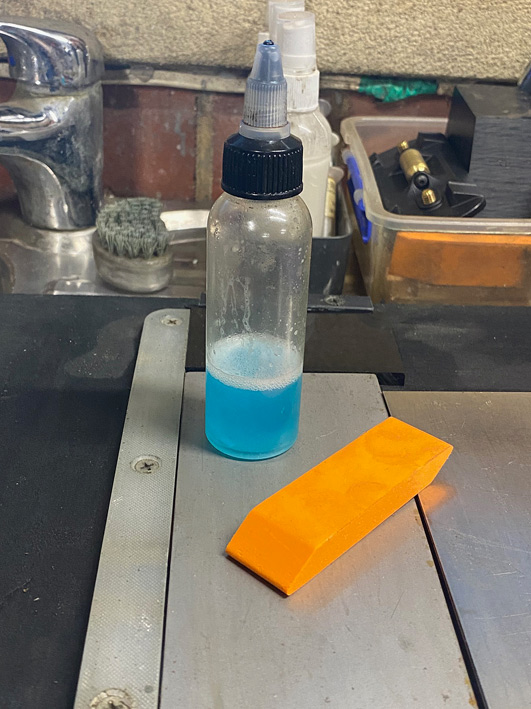

The eraser (also available from Temu) is used to clean the diamond plates. This is the reason that they look new. The liquid in the bottle is glass cleaner, and is used to lubricate the stones.

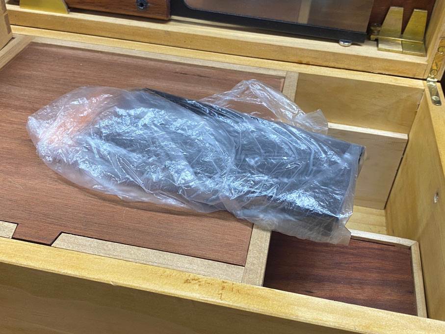

At present all is bundled up in a plastic bag. I have not yet worked out where it will go in the box. It does not take up much space.
