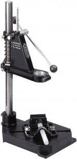

I've also looked for a good quality portable drill stand. The ones that caught my eye are made by Wabeco. They aren't that expensive I just wonder if they're available in the US. They also fit a 43mm drill collar.

Is only part of this adapter used in the YT video to mount the Multimaster?
I don't see where the clamp and hand screw are used to connect this to the drill
stand. Who makes that particular drill stand anyway, does anyone recognize it?
Edit: Looking at this video it appears to be a Wolfcraft unit.
Amazon...Wolfcraft 5027000...$288.00  I've used the Fein adaptor with my Makita portable drill press stand (doesn't seem to be available any more).  The problem with the Makita and most other low cost solutions is that there is no vertical guide to prevent the mechanism from turning on the column.  There also is deflection in the lowering guide assembly.  Not really great for precision work.
