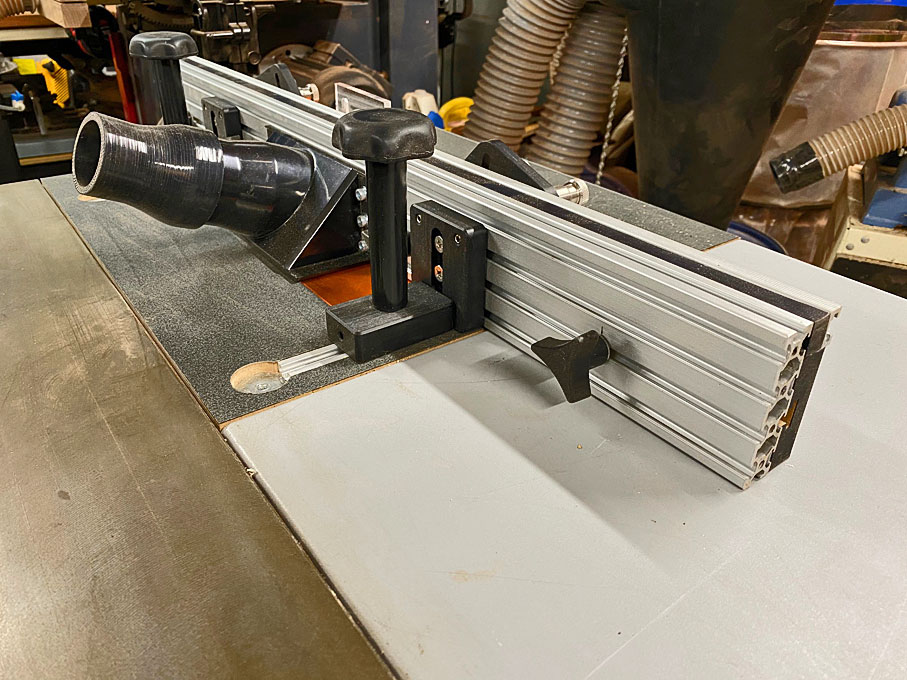

My router table fence is also built into the outfeed of a tablesaw, in my case a Hammer K3 slider. The build write up with details is here:http://www.inthewoodshop.com/Powered Tools and Machinery/RouterTableAdventure.html
Dust extraction uses dual hoses out of a Festool CT26e to suck from behind the fence and from the route bit.
Router fence connected to the rip fence. This enables the use of the fine adjuster on the rip fence...

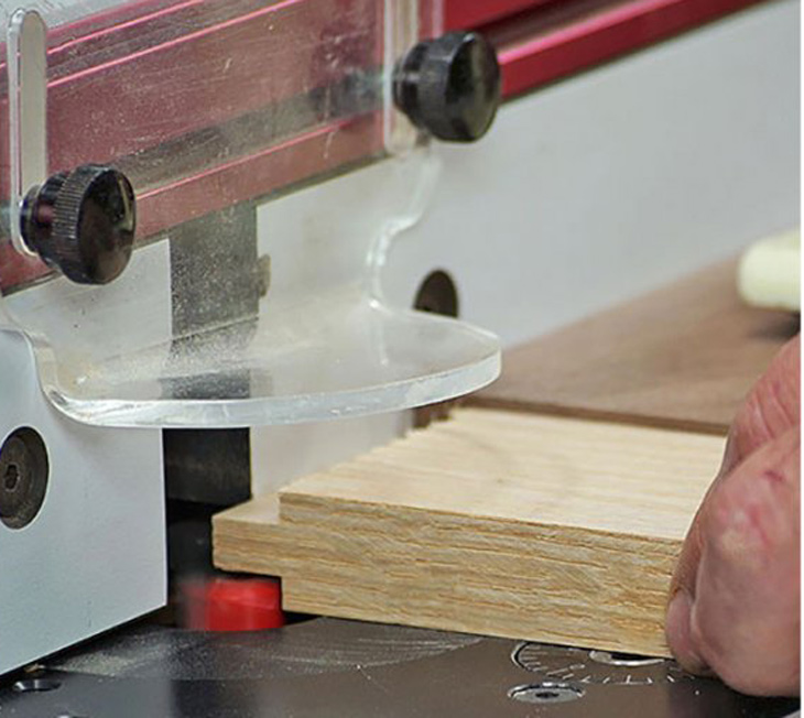

I'm looking for a guard that attaches to the T-slots on the face of the fence that sticks out to cover the bit. Something like these:
But made from polycarbonate, not acrylic. Anyone got a link, otherwise I'll hit up my local Tap Plastics to make one up.

OK, my fence build is pretty much done. Like my earlier fence, which I built in like 30 minutes, it uses what I call a "bridge" board that has some wood glued to it on the right and the fence itself is attached at the left. I clamp the bridge board to my tablesaw fence, which has a Wixey DRO. But, I've made many improvements over my earlier quickie.
This one is built around a 30150 aluminum extrusion for the support fence, which is 30mm thick and 150mm tall. I particularly wanted the extra height for on-edge routing. I got some phenolic-covered 18mm plywood from MakerStock, which seems pretty decent. It's a smoother surface than melamine, it's black instead of white, and the core is many layered plywood instead of MDF/particle board, so hopefully it'll hold up better. Note that the phenolic covering is pretty thin, but seems thicker than the melamine I've used previously.
Here's a view showing the back of the fence:
[attachimg=3]
The clamp holds the bridge board to the back of the rip fence so I can micro-adjust. Since I have a SawStop cast iron table embedded in my tablesaw wing, I added a couple of MagSwitch magnetic holddowns to hold the fence in position. My rip fence is attached only at the front and I use just one clamp, so with vertical featherboards I was worried about the router fence lifting. Plus, once the fence is in position, I can decouple it from the tablesaw rip fence in case I need to use that for ripping without disturbing the router fence (although with the DRO restoring a previous position is pretty easy). I got the MagSwitch 150s, which seem pretty strong, but the 235s are probably more secure, although more than twice the price. Note that these MagSwitches are designed to fit into a full ¾" thick board, so with the 18mm plywood I use to shim it up a bit, which I did with a couple washers where they bolt to the bridge board.
A couple construction notes here: Although MagSwitch says to just use a 40mm bit to drill the hole, I used my CNC to rout the chopped off mortise that fits the actual shape of the switch closely, preventing rotation even without screws. And I used dominos to attach the clamp board to the bridge board, but got impatient with glue drying and added some screws from the bottom up, too. The clamp board is notched since the other side of my rip fence as some protrusions. One advantage to this notching is that it firmly locates the router fence front and back relative to the table.
I used some "40" angle rail attachment brackets to hold the aluminum extrusion at right angles to the bridge board. If you look carefully at the L bracket closest to the camera, you can see a feeler gauge shim where the bracket attaches to the bridge board. This was needed to get my fence properly perpendicular to the table at the front - the rear is spot on without shimming. I think this might be due to putting glue on the blocks that were needed to get the L bracket holes to align with the extrusion. But even the cyno glue I used doesn't really stick to the phenolic, so I'm really relying on the screws doing through the block into the bridge board here.
Here's the business side of the router table fence:
[attachimg=4]
You can see the JessEm lift plate, which has an old Porter-Cable #7538 3 router mounted. I haven't bothered to notch out my tablesaw wing for the router table's miter slots, since my only use for them is featherboards, not a miter gauge.
I've got 3 movable/removable fence surfaces: the bottom two are split in the middle for the typical bury the bit in the fence type routing. I had to notch out the 30150 aluminum extrusion to create a suitable holed for both bits and dust extraction. The plywood fence above has a T-Track mounted at the very bottom (for feather boards, stop blocks, and an exposed bit guard). My idea is that this stays put unless something happens to it. I forgot the exact height of the fence, but it's something just under 200mm.
I don't plan on doing any edge jointing, but I could easily add shims to the outfeed side of the lower split fence if I change my mind.
Note that since I chose the black phenolic covered plywood, I decided to get a black T-Track, and since the factory edge of the plywood was painted black, I painted all the edges black.
I should go through and see how much I've invested in this fence. The 30150 extrusion was about $76 from Amazon, the MagSwitch 150s were $80 from Taylor Tool Works, the sheet of plywood (2' x 3') was $64 shipped, and then some miscellaneous hardware (T-nuts, metric bolts, the L brackets). So overall, more expensive than the standard commercial fences, but less expensive than the fancy ones from Incra or WoodPeckers or JessEm.
I'm still looking for a polycarbonate bit guard. I believe polycarbonate is more shatter resistant than acrylic, which is why I'm looking for an alternate.

I'd suggest you use Lexan for your guard. Much tougher and easier to work, with power tools, than acrylic. You can get it from Amazon. I used gel CA glue to put the pieces together and have had no issues. I suggest using painter's tape to mask off outside the glue lines in order to make the finished product look better.
Since you've mentioned dust collection, I also used Lexan to build a dust collection box under the table that captures the dust above the router motor air intake (inspired by one at SauterShop). First is a picture showing the sliding partition that captures the dust above the router motor when it's installed in the table. The second shows the box installed in the table in which the router moves up and down in the Jess-Em router lift. Note, the hose is not shown attached in either of these photos but you can see in the first one where the Festool hose fitting attaches to the "bottom" of the lift plate. I have a hose attached to the dust collection box and the back of the fence, using a splitter. It's not 100% dust collection, but it's several magnitudes better than what I had before.
Good luck with your project.

Thanks - Lexan is a brand name for polycarbonate. I guess I can glue something up myself after all.
