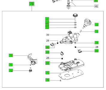

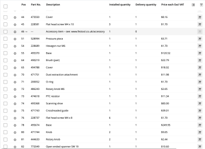

Not quite sure what you're looking for...are you looking for the vertical base?
If so, it's available from Festool spares but it's not cheap. Part number 495674 at a cost of $250.

Yes, thank you. This is what I was looking for. Can I ask you where do you get these part numbers from?
