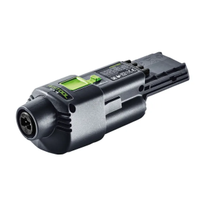

Can anyone tell me whether the “Festool Power Adapter ACA 18V to 240V Ergo” (note that I am in Australia, hence 240v) works with the Festool ETSC 2 18v 150mm Random Orbital Sander?

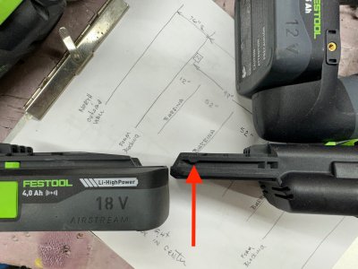

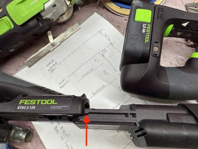

No & maybe Derek... :(
There are 2 small stops that are molded into the channel of the ACA Ergo Adapter that prevent its insertion into any standard sized battery operated tool. However if those stops were removed...🤔
I wouldn't be surprised if besides the mechanical incompatibility they also have an electrical interlock as in the tool 'reads' the battery.
It still wouldn't lock into place.
