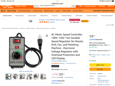

So it sounds like the vac doesn’t have variable speed ? You can slow it down or vent it (at the hose) a variable speed router control can do this as well I used one for years on a Fien vac with just an on/off switch…still have it and runs great, this was before my Festool ones…I also see a RTS or DTS 400 in your future for all the corners you’re going to run into

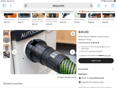

Welcome to the FOG !…..here’s an example… Rockler had one for @$60 but I had a $30 one work just fine

Thanks so much for the reply. We have looked ( spent way too long deliberating !!!! ) at the RTS and DTS too ! Decided that we could buy a cheaper mouse type sander to help with the corners however if we can make the Numatic hoover work for the dust extraction we may decide on the DTS too ! The numatic doesn’t have variable speed and we had thought about those external switches.
Thanks for the links !!
You could also buy the Bosch hose if it will fit the vac (same fitting as Festool hose), it has an adjustable breather slot at the nozzle end to reduce suction.
