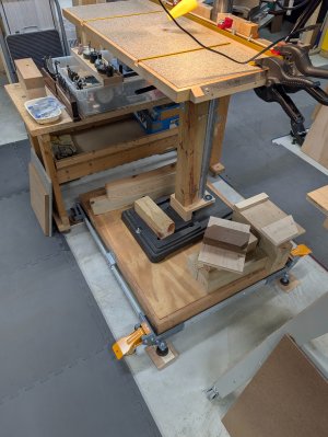

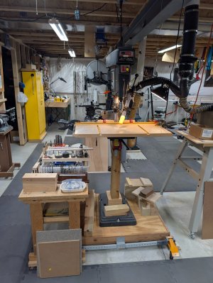

I have mine on a base with wheels. I picked up one of these
Then I mounted it on a thick piece of heavy duty plywood and everything is bolted down. It's very convenient.
When I move it, I go slow and I am cautious. It's been great for me for many years.
Sorry for the mess in the picture :)
