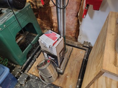

My garage is my shop so my tools need to be mobile. I built a mobile base for my Nova Voyager out of a welded fabrication of steel. I have a small welder but not a very experienced welder and this base came out great as did a lock-lift-'N roll base I made for my lathe. Fun project!

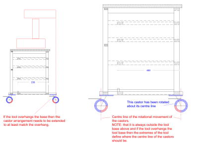

This may help but do note the precautions that I take to stop it falling over. It is easy to do and the drill can be moved easily but must always be re-secured before use.

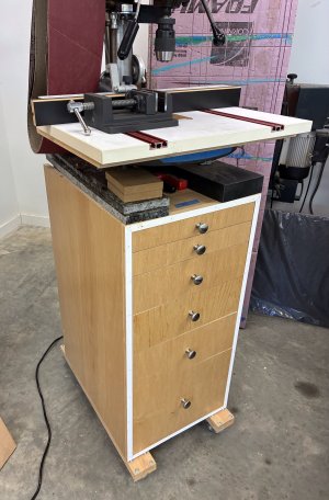

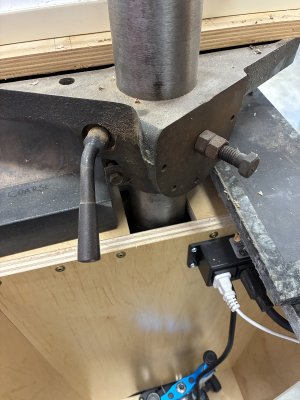

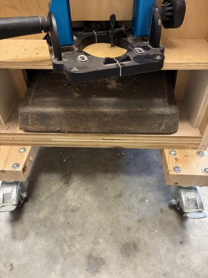

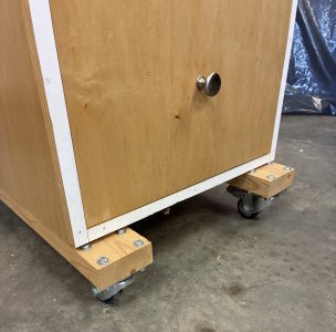

I built a cabinet around the base and column of my old Craftsman drill press. Have liked having all the bits right there at the machine. One downside is that the casters and base do make the table a bit higher than I’d like. But overall I’m happy with it.

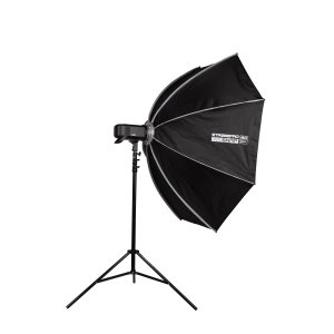

The three legged stand works well for cameras which are always centered over the stand, but not so well for lighting equipment which is often cantilevered to one side.
In the image below, a light-weight fabric soft-box is mounted on a stand. Even with the light weight, the soft-box should extend directly over one of the stand’s legs. It is not clear to me that is what is illustrated in the photo. They do sell sand bags for weighting down the stands. A bit help. It would work with the drill tripod also.
Sand bags, a low tech answer:
Any engineer will tell you that for the application in discussion the CofG must never be beyond the line between points of contact with the ground. This means that 4 castors or feet at the corners of the rectangular box/base will keep the CofG within the area of the base. For a tripod the CofG must not extend beyond the centre of the line between any pair of legs. This means that the legs are likely to be a nuissance.
Thanks for that information. I knew from experience that 3 legs is less stable than 4 legs.
So my light stand base, which was round and had evenly placed 5 casters, was not only easier to maneuver (with swivel casters) but would be more stable, if I understand the principle set forth in your reply above. Yes?
Whatever pattern/number of castors used the corners of the cabinet base must not extend between any line between adjacent castors. My preference is to have a rectangular cabinet base with 4 castors which have their point of contact with the floor about 40 mm beyond the corners of the base.
