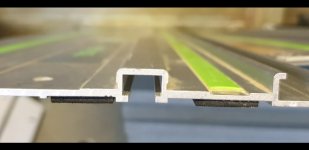

This has been bugging me for a while and hopefully someone on here can shed some light on it for me. On a normal FS rail you have the slot underneath which clamps it to whatever you're cutting. Brilliant.

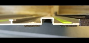

The FSK rails have a similar slot but with the lips that clamps hold against are a no-show.
[attachimg=2]
Any reason why they're not there on the FSK rails? It would seem like a standard rail feature, so I'm perplexed as to its absence. Only a little bit mind you [wink]

My suspicion is that rail wasn't intended to be used in that way.  It's intended to be affixed to the saw base and since the rail cannot be used with a standard TS saw, there was no need.
It will be held down whilst in operation by the saw. The reason it cannot be clamped, is about safety, the rail and saw shouldn’t be fixed to the workpiece, so in the event of a slip, or the saw getting knocked of the work surface, the workpiece can easily separate, avoiding more potential danger.
