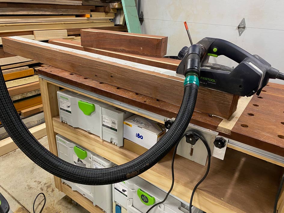

Man, I really wanted to like this. Bought the 36mm hose and all. I’m working on a walnut project and gave it its first go by trying to plane out a middle section of a board.
Started easy- 1/32”.
The chips. More like strands of wood fiber that birds would be thrilled to have for a nest. They clogged the exhaust port. They clogged the hose. They clogged my cyclone. Then after all was clogged, they shot out of the front of the planer. Everywhere.
Ok, so I decided user error. Spent 2x longer cleaning up the mess than I did with the 10 passes making it.
Round 2. More mess. Caught it this time.
The planing: again likely user error. I found it amazingly hard to set a flat plane across the board. A slight overlap and the pass becomes uneven. A slight miss too wide and you miss a section. Attempt to pass over the missed section and it lowers the 2 sides of it along with it.
Now if you’re taking one long pass it does amazingly well. But any passes wider than the planer and I really struggled.
Any overlap causes uneven cuts. Any misses cause uneven cuts. Very frustrating. It’s clearly a workhorse and I regret I suppose I’m not skilled enough to use it. So, I’m returning it. :(

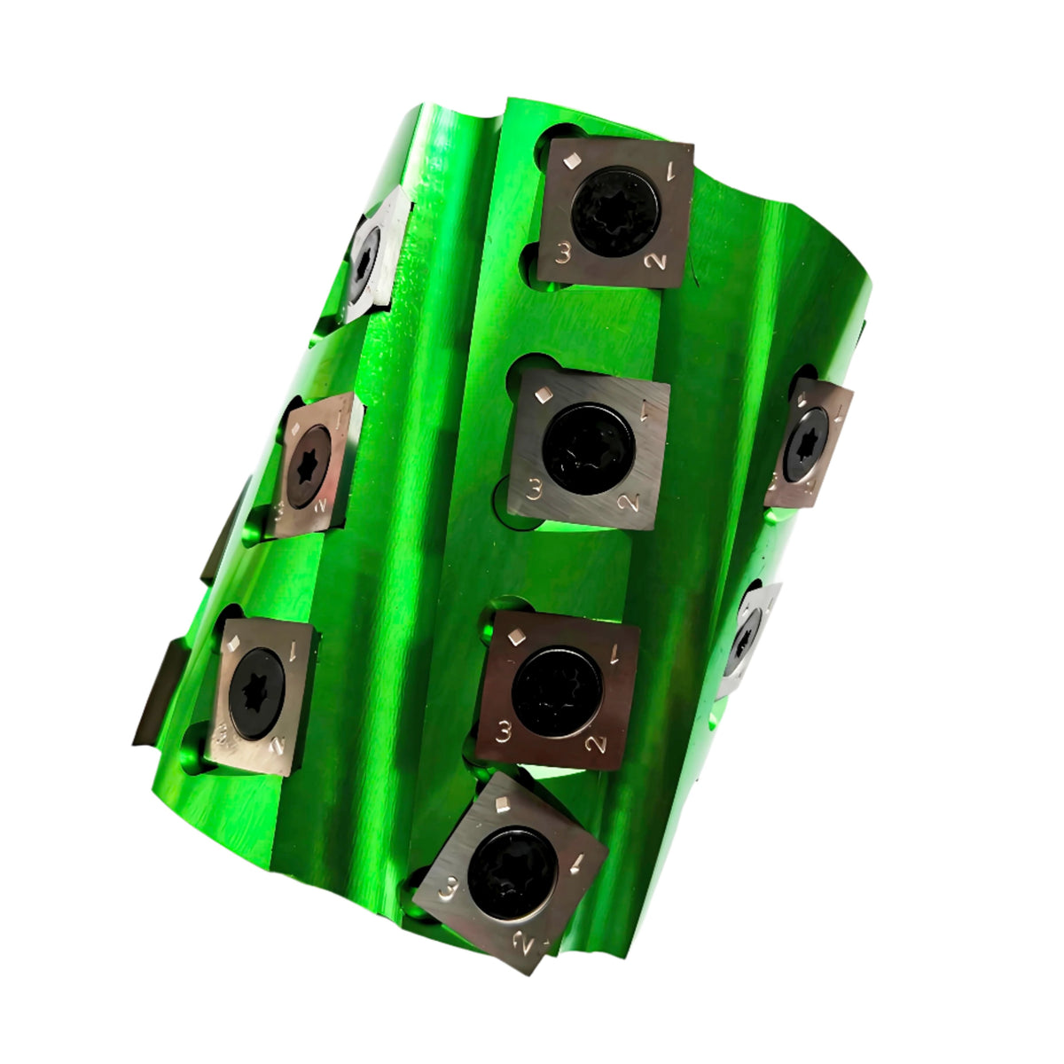

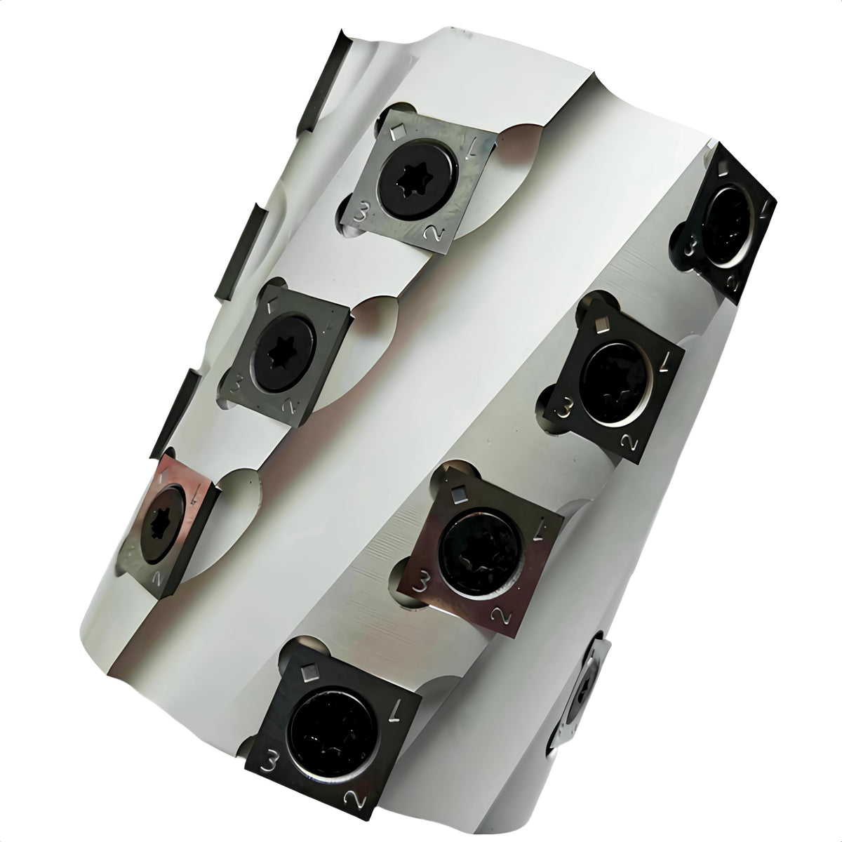

But this spiral insert cutterhead from CSP Tooling for the HL850 will make it an incredible beast:
I put this head in mine and get small chips now and amazing DOC and finish results. Couldn't recommend it high enough.

I can't believe how good the one I have is. And dirt cheap too considering the very high quality. Aside from adding heaps more grunt to easily cut deep into really hard timbers, it's also a little more quiet in operation unless I'm mis-remembering.
This video shows it doing some deep planing on Blackbutt which is a notoriously hard timber that loves to blunt tools:

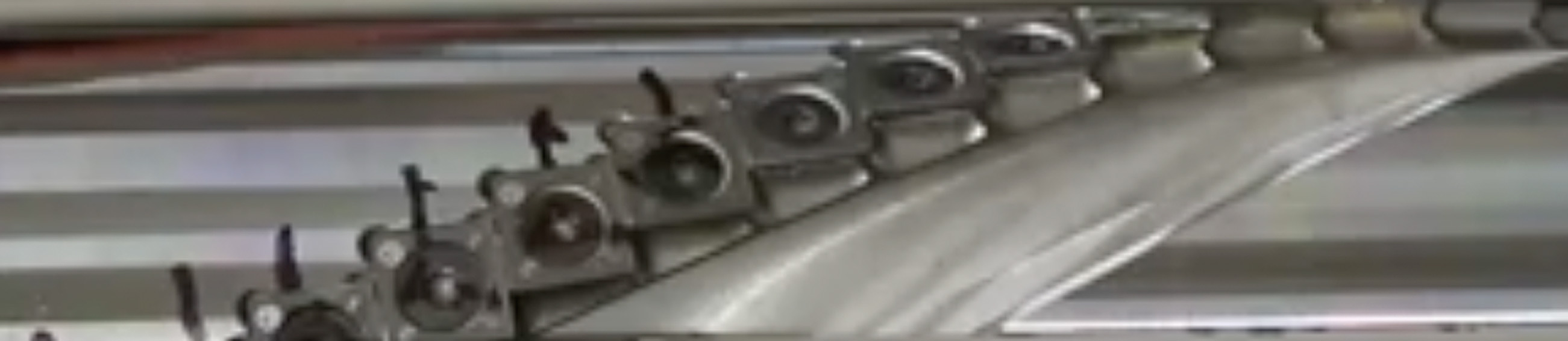

I have one of these for my EHL 65 E. It has not yet been installed as I have a few spare couple of standard blades, and paint-covered Jarrah posts to strip. However ... while the cutters on the "spiral" insert run on a spiral-looking fitting, the cutting edges face forward rather than at an angle. There is no shear cut here, only multiple, smaller, segmented cuts. By comparison, the inserts of my Hammer A3-31 are clearly angled (just replaced the original inserts after 12 years) ...
By contrast, the straight (that is, non-segmented) original blade does do a shear-cut ...

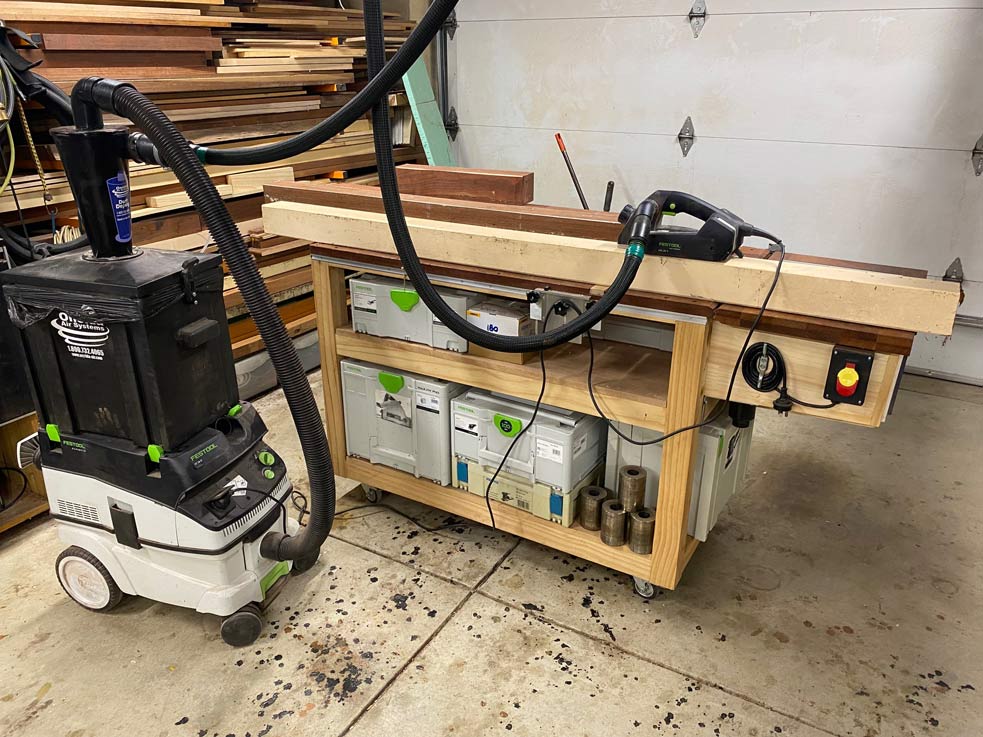

I had too tear out 12’ of my kitchen wall after discovering water damage when replacing the roofing with standing seam and insulated subbase. This was in my kitchen which has a shed roof peaking at 17’. The ceiling is sprayed texture that I applied 33 years ago. Needless to say I didn’t want to disturb the finish. In order to make an angled support for the ceiling I made two angled edge 2x6 supporting the carpeted 2x12 that went against the ceiling. Sorry, long build up to short explanation. I cut the angles with my 850 using 50mm hoses as I have 4. I had no chip clogs this way. I had originally tried using the bag but that was ridiculously irritating. The whole apparatus was held up with adjustable steel posts and worked for the few days needed to replace the walls.

Just noticed that CSP offers both a spiral cutter and a helical cutter for the HL 850. I wonder how much difference there is between them? 🤷‍♂️

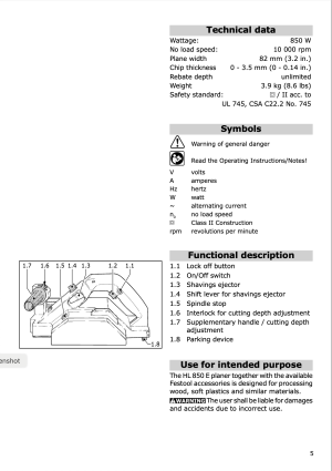

@Leo95se the owners manual states that the chip size is continuously variable from 0 to 3.5mm.
For a cutterhead that size I doubt you'd see a significant difference on the finish, but for the minute extra cost I reckon the shear would be the one to get, and would probably be that little quieter still. The difference the one I bought made is astounding.
