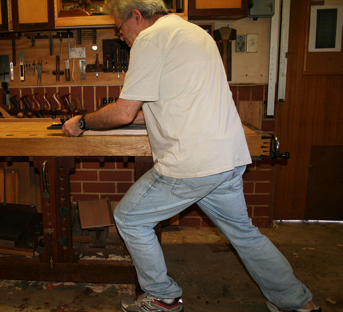

The second factor is body mechanics,  that is, how you hold the plane to the work piece. In this, your body needs to be over the plane, pressing it down and forward. This is best practice with a Stanley #7 jointer plane ...
Linked this this last point is the height of your bench. Yours is too high for ideal body mechanics, and instead you are leaning upward and off balance. This is a the height for relaxed and controlled planing ...
onocoffee said:
[member=4358]derekcohen[/member] Thanks for the thoughts. What would you say is the ideal height for the workbench top when planing. This bench is at 920mm (36").

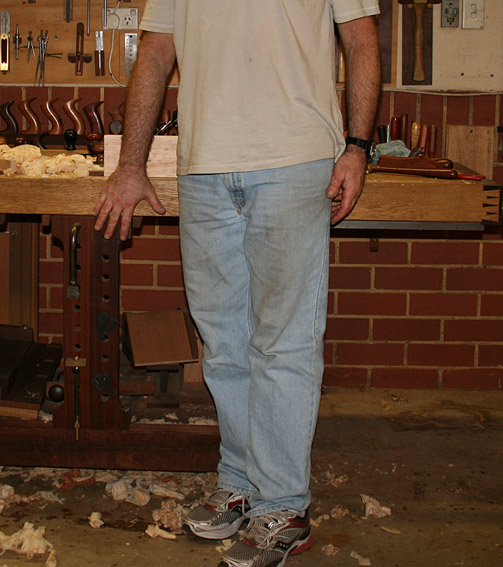

How tall are you? 36" would be very high for me, and I am 5'9". My bench is 32" high. This will give you an idea ...
If this appears low, what you need to realise is that we plane/push with our hips and bend the knees, which lowers our action height. A bench for planing is lower than a bench for sanding or routing, which is why I also have an MFT.

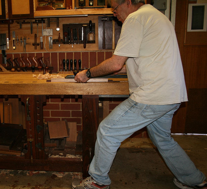

When planing, we start here (note the bent knees, dropping my body) ...
... and moving forward ...
Think of karate, where punching power comes from the hips, and tennis, where we drop our stance for balance and control.
