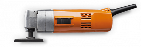

If it looks like this model the housing does indeed get pretty hot. After 10-15 minutes of continuous use, I'd have to put on heavy leather gloves to continue to use it. After still more use, I'd have to swap it between the right and and left hand to allow the glove to cool down.  [eek]
