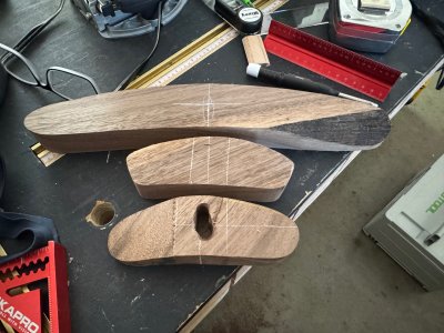

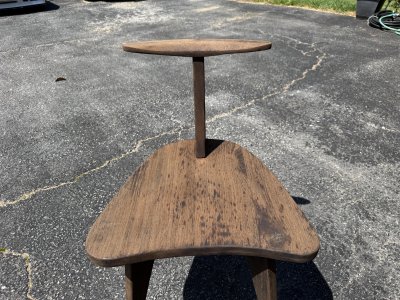

I’m trying to do this properly. In the two chairs I’ve built, I’ve really approached these mortises with some measuring but mostly by using “The Force.” The one is the pic is slightly off.
I’d like to figure out a better and more precise method.
Yesterday, with a shorter back piece, I struck center lines to align with the center marks on the DF500, and then made the mistake of plunging it by hand with no clamps (the DF500 was in a dock).
Any thoughts on how to more accurately drill these 10mm mortises? I’m shaping them on an oscillating sander and can’t say my dimensioning is perfectly proportionate.
You can see in the second pic the muck up and the other two back pieces I’d like to mortise today.
Thanks!

I would suggest cutting the mortises while the workpiece is still rectangular, then cutting the profile afterwards. That way you have better alignment to the mortise position and something firm to reference from.
Clamp a block 10mm offset (assuming you're using a DF500) from the mortise and then use it to register against the bottom of your DF500. You may want to see the supplemental manual on mid-panel dominos.
That would be a much better solution for keeping the work piece square and true. Also cut two template pieces the same size as the work piece BEFORE cutting one to the finished contour so that once you get this right, the remaining work pieces will be far easier to duplicate.

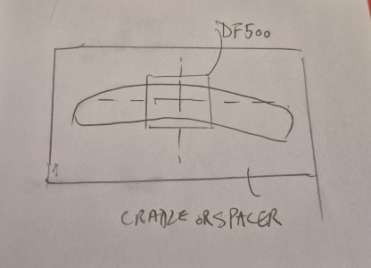

As you've already cut the pieces to their final and small sizes, you need to enlarge their registration surface. One way to do it is surround them with spacers or a cradle roughly of their shapes (everything can be double-face taped to the bench) . Extend the intersecting lines of the center point and align the DF base with those lines.
Whether you hold the machine freehand and plunge or clamp a fence as suggested by woodferret depends on your comfort level.

"Free-handing" just doesn't go so well, most of the time, and the 10mm is probably the worst at it.
You need some kind of register, to help support the base of the DF500. Double sided tape or some CA glue can be very helpful, when dealing with small parts
As some of the others have said, ideally it would be better to cut the mortices when the parts are still larger and square, but we're past that now.
