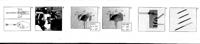

I hit a screw with one of mine a couple of months ago - I was pretty upset as you can imagine but it was easy to sort out.
There are instructions with the drills that show honing angles and so on but I just used my eye. First pop out the centre pin and then hold the drill in a vice or chuck or whatever suits you. I then used a small diamond file and gently touched up the surfaces. Everything is honed flat, unlike Forstners, and so it is quite easy.
I do not claim to have made a perfect job of this but I do know that it has made a big difference to the cut quality. I have, as yet, not asked my sharpening service guy how much he would charge for a Zobo but will do next time the saw blades go in.

Hi Jools
We met up at the show in Kent last weekend and i promised to get the information so here it is. Not the best copy as the paper is very small.
rg
Phil[attachimg=1]
