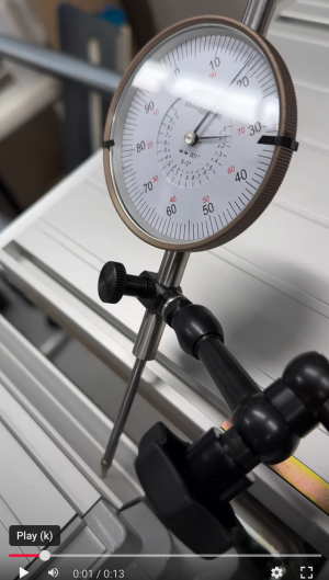

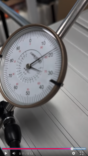

I think the real question is how you measured a right angle wooden board that accurately. That Woodpecker's square in one of your photos is accurate, but not that accurate (claim is +/-0.0254mm along a 450mm length for its largest square). You're claiming a full order of magnitude better than that for something made of wood.
When I do inlay work, I find anything less than 0.05mm is indistinguishable from nothing.
Two screenshots of a video showing the results.
