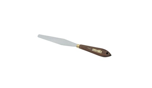

I've been using the small spatula's often used by artists. I have a few different shapes. Works like a charm for me and gives me a bit more control than a clipped throw-away brush (which I also use). They look very much like this one:

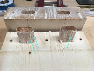

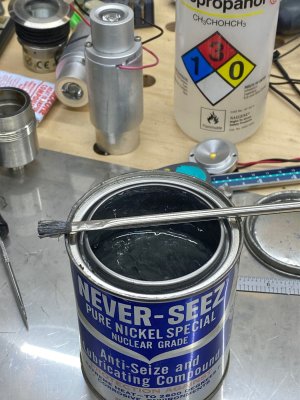

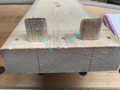

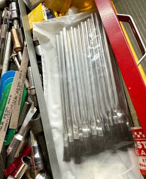

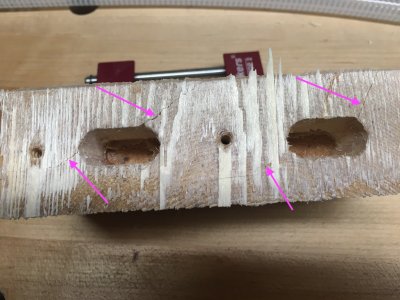

I prefer to use flux brushes. If the bristles are too long I just shorten them up. Here are the results of brushing glue on all the wood joints...including the outside of the Domino and the inside of the mortise. This was a fir joint that I left overnight to dry. It was really tough to break this joint apart as the outside of each Domino has removed wood fibers from the inside of the mortise. Also notice the 4 cracks emanating from the mortises. A bonus round for using flux brushes is that they are useful for applying other products.
