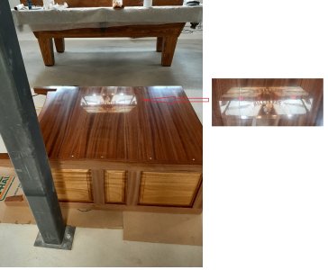

See below, sanded through 3000 grit then polished with Mirka Polarshine 10, then Mirka VF-5
(actually just a dresser back-panel, but my first attempt at polishing)

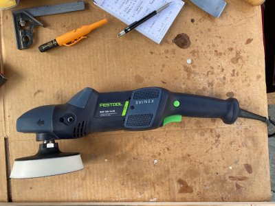

In relation to this discussion about polishing. I've seen that Festool has and orange and other polishing products. Then, at my local supply house, they have Meguiar's products that seem similar. What kinds of pads and product do you need to successfully polish finishes? This is something I am completely unknowledgeable regarding.
Actually, Festool has discontinued a lot of their polishing equipment and polishing accessories. They offered many more sponges & polishing items 15 years ago. 😭 They even obsoleted their Shinex around mid 2022. Here's some polishing information from Festool.
