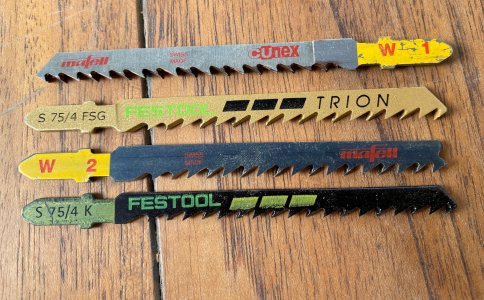

The blades marked "Trion" are thicker than conventional jigsaw blades. The tang thickness on Trion blades is 1.68 - 1.70 mm while the tang thickness on Festool blades is 1.30 - 1.46 mm, Mafell runs right around 1.50 mm and Bosch blades run around 1.26 mm thick.
