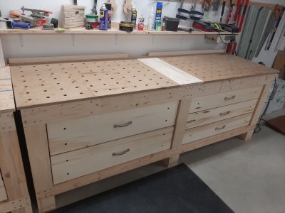

Hi all!

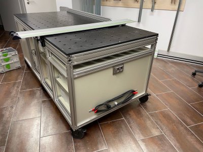

I searching the web for plans to do something like this for my workshop IMG_7615.jpeg
Don’t wanna spend god knows how long to design and develop one. If I could buy plans I would appreciate it.
Any pointer would on where I can find plans for this?
If the build is in Aluminium’s extrusion, that’s a plus.
Thanks!

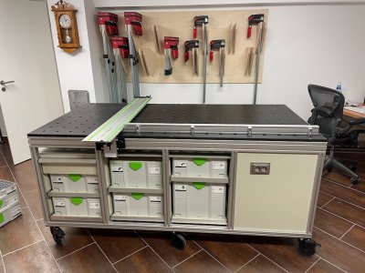

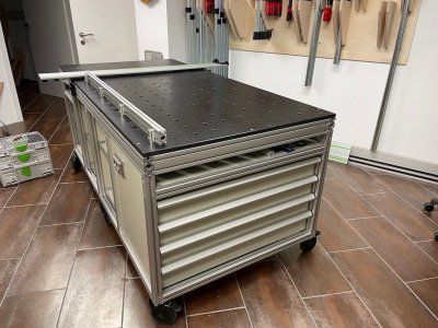

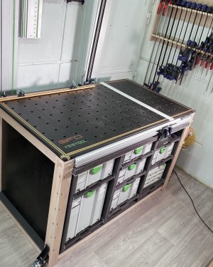

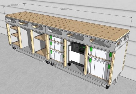

I built this bench a while back.
If this is similar to what you are looking for, I can give more details. I did a 3D design but only made a handful of basic drawings of some of the components.
It's 8 ft long, and uses two standard Festool MFT tops. The center portion is replaceable if putting a swing-down rail, but I never did put the swing down rail.
You don't have bottom access to the MFT top with this type of design, but I have not found that to be a problem.
If you want to use aluminum extrusion, Fazstore.ca near Montreal is a good source, but be warned that aluminum extrusion and connectors gets expensive rather quickly.
Looking great!
The only thing I’d change/want is space to store my systainer under. Where do you store yours?
Looking great!
In the first image you can see them on the far right --- stacked up on the floor.
Drawer space is too valuable to give up just to stack systainers.
If you look at the second last or third last image that you posted, that is really the same as stacking them on the floor, except harder to retrieve because you can't lift one straight up.
If you put each systainer on a pull-out shelf, that is reasonable, but I would still prefer not to lose the drawer space - systainers can be put anywhere.

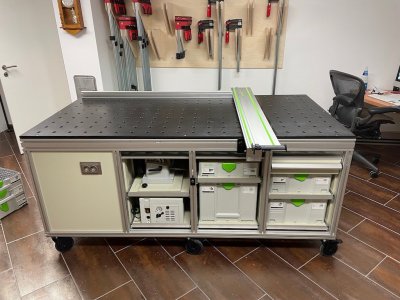

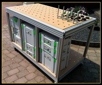

I built a MFT-style workbench for my basement shop using extruded aluminum that has lots of Systainer and drawer storage.
Here is the link to my detailed build thread on a UK forum that includes the SketchUp SKP plans and the assembly plans from the company where I bought the extrusion.
Oh wow! That’s what I had in mind! What’s the format? How much did it cost you? I’ll go check your build thread! 😍

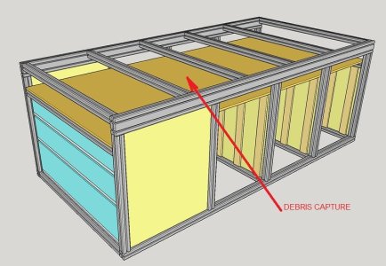

On an MFT bench, don't forget this important feature.
All sorts of chips and assorted "stuff" will fall through the holes in the top.
(I have some slide-out trays below my top)

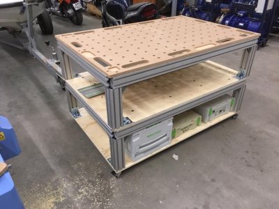

I have this 30x60 workbench already. The dogs are not complete and it’s only on legs without any type of storage IMG_7649.jpeg
But is has a way for me to clean the dust and chip inside.
