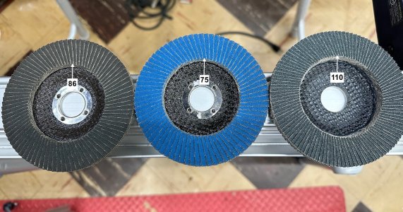

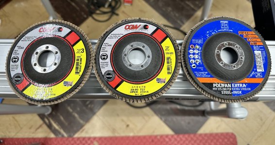

Are these the ones you use?
or
4.5" half the price of the 5"
Or:
Or something else entirely?
or
Or:
I use the Lennox you posted, and the Milwaukee Steelhead as Ron mentioned above.
