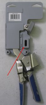

Just an FYI for those that might purchase these clamps - the screw is in a little pocket in the packaging, I missed it the first time!
[attachimg=#]
[attachimg=#][attachimg=#]

Thanks ---
Kreg doesn't carry the spare part but would send me a new clamp (that is top notch).
