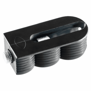

I recently picked up a CNC Router and am looking to make flatpack furniture. I am looking for feedback from anyone that has used the Lamello Cabineo connectors. Thank you.
I may look at those more closely. I hate the white and black but the have colored cover plates. Even the Shaper Origin Hub has downloadable plans for installing those. I like the ability to use the shelf pin holes and locking the shelf into place after the carcass is built.
I spoke to the US Distributor for advice and they recommended the Cabineo 12 with the brass bolt and brass receiver that is set in the other piece to be connected. They said this will create the strongest connection. They offer multiple ways to secure materials to meet different requirements. They are sending me a few samples to experiment with and I will report back to this thread.
