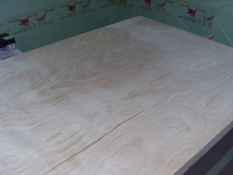

Okay, here it is and I started this pass from the right hand corner.  I couldn't preview an attachment of it but I think this is bigger and easier to see.  I noticed that the Rubin 2 disc had a lot of sawdust clinging to it, something I didn't have previously and it did vacuum right off.  I was thinking of making a quick pass with a fresh disc.
These doors are in no way flat either, lots of woop de doos in them.  I first thought that the veneer was one thick veneer but found out that it was a three layer.  I was going to flatten them out in Rotex mode.  Yep, burned right through the first layer.  >:(  Good thing is on the backside of a normally open door near the hinged edge!

The first pass was with 40 grit Granat, 60-120 grit was stuff from Lowes, 150-220 grit is Rubin 2 and the picture is from 150 grit.  I'll just have change discs more frequently.
