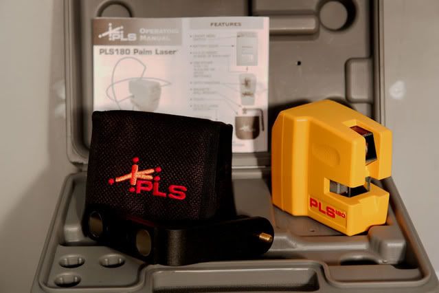

PLS 180 mini Review

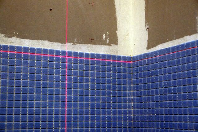

After unsatisfactory attempts using a 6' Johnson level and then a water level on layout for this glass mosaic tile (3/4" tiles on mesh backed sheets - Hakatai)  project, I caved in and got the PLS 180.
The +, - variables with the johnson were just too much for this one. The water level process while good as far as accuracy goes was cumbersome, and did not give the vertical needed.
The tiles in this master bath will cover all exposed wall space from floor to ceiling requiring the tile grout lines to run a nice continuous line all the way around the room.
The grout gaps are about 1/16 to 1/8 " and this laser is just the ticket to insure a plumb and level grid.
The 180 is self leveling and is mounted on a camera tripod here. It projects lines as the model # says - 180 degrees. Half the room is projected in very bright easy to see lines. It can be left on for the duration of the task. Then moved at will any time. I got the basic unit which is about 3"x3" x 1 1/2" thick.
It's an awesome little tool and will see allot of action for many future projects. After checking out the many laser options - rotators etc, the cost and quality of this unit looked good for the price. And I am more than pleased with the quality of this one.
If your in the market for a mid priced ($255.00 to $275.00 for the basic unit) laser level, this is one to check out.

The set up buttons have a red - green light to verify the self leveling feature. The 180 feature is real nice and makes easy and fast work of marking or verifying complete around the room layout. Floor - ceiling also. It has an internal compass like level I think but I won't be taking it appart to confirm that. I can see that dropping it would not be a good thing but it feels solid.
This helps you by making your work seamless, without interruption to measure ,verify recheck. So your work is checked in "real time" as you go. (OK now that sounds more like a review) Must have read that somewhere else.  ::)
