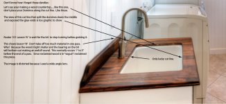

And lastly...  [scared]  [attachimg=1]
[attachimg=2]
Why not....[attachimg=1][attachimg=2]

It is great that you are so honest as most wouldn't show the shots you are.
What you will learn with any fabrication is that it is easier to stop, remove the problem and start over vs trying to redo it. In the amount of time you spend hiding or jury rigging something it would be easier and a better job to take a deep breathe and make a new one correctly. The learning process will be invaluable for future projects.
I think like most novice fabricators you rush to get to the final product. Patience is key. Spend a few extra days and don't buy paint or finishing products until you are ready. No temptation to rush.
I would choose one error a day and just take it off and fix it. Nothing is ever perfect. Craftsmanship takes time and thought. There is nobody who does woodworking that doesn't have a pile of redone projects.

roofie, thanks for the compliment.  You got me thinking  (smell the wood burning).....  there should be a forum category called "learning from mistakes".  I posted the photos in the hope that I can save others a "Well Duh" moment.
For example the counter top photos.  Show novices and remind mid-skill folks that just because that "arf arf" big dog router can hog out material you should make multiple passes.  A good visual reminder showing $10 of rosewood blown out.  And, "well duh", you need to plan the placement of your dominos if you are going to cut out material.  I hope those images stick in the readers mind.
