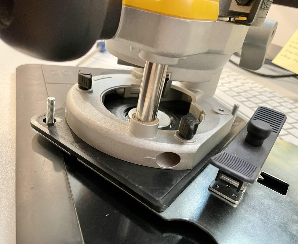

I am working on something similar to what you are looking for, but it does not
check all your boxes with the routers it is currently intended to be used with.
Mine is centered around using a compact 1.25HP cordless router such as the
DeWalt DCW600b or a compact corded router like the Porter-Cable 450PK
though it could could easily be made to work with mid-sized (2-1/4HP) routers
providing they fit on the LR32 plate.
You can read more about it here.https://www.festoolownersgroup.com/...-lr32-base-plate-adapter/msg662086/#msg662086
The new version of the OF1010 is supposed to be shipping soon, but it won't take 1/2" bits.

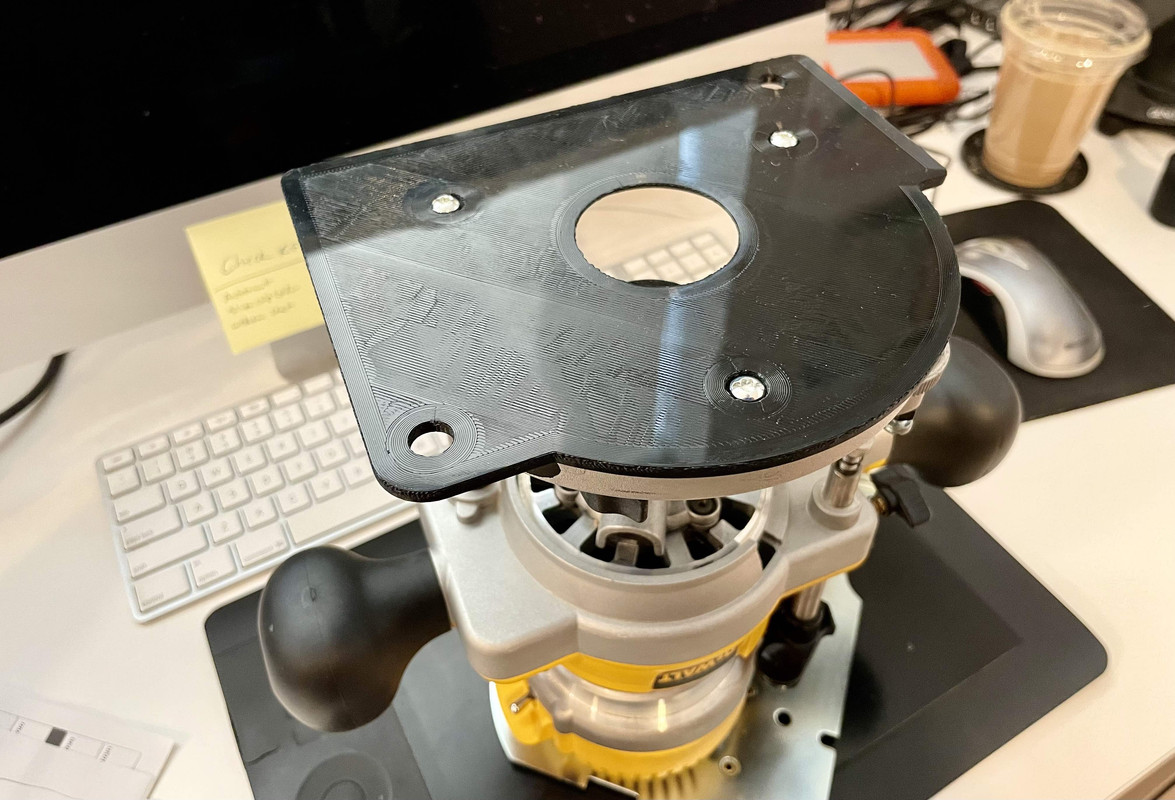

Piggybacking off [member=60461]Bob D.[/member] 's thread, I'm in the middle of making a 3D printed adapter plate for my full size DeWalt DW618, which comes with 1/2" and 1/4" collets, and could accept 8mm with a 1/2"-8mm collect reducer (Amana Tools makes one, available on Amazon).
Depends on what you mean by "modification", but I'm guessing there are very few 3rd party routers that will work without some sort of intermediate solution, like an adapter plate.
If you for some reason happen to go with this particular model, I'd be happy to share the design.
I will have a video out soon (probably later today) showing my adapter kit in use.
I'll post a link in the thread about my adapter build.
