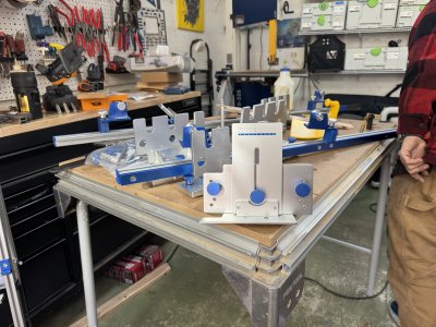

I've always been thinking about getting an MFT - even though I don't really have the space, I've rationalized that I could use one for those nicer days when I want to set up outside and do some power carving (because I do power carving "all the time" - more like twice in the past year).

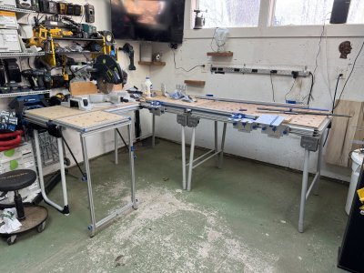

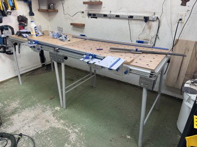

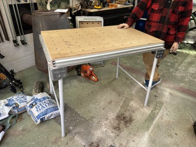

Recently, my friend bought a whole MFT/Dashboard setup from a seller on Marketplace and it arrived today. The seller had two MFTs, an MW1000 extension, two Dashboard Outriggers and lots of Dashboard hardware. My first time seeing the Dashboard stuff and it's quite robust. As I was helping him set it up, I was a bit surprised by how heavy the MFTs are. Definitely much heavier than I would like to haul in and out of the garage for all those times I like to do power carving.
For those of you who setup MFTs on the regular at jobsites: Respect. I might just end up getting that Klein portable that Lowes has on special for $99.

Bare MFT/3 with legs should be 28 kg according to Festool. I don't move mine that often. But it's easily doable if you are big enough to hold it the easy way. I'm slightly above average length, but being Dutch... that distorts that picture a bit in the worldwide perspective. Lets just say I was very happy Festool raised the height of it compared to the previous line of Basis Plus and MFT that were only 820mm instead of 900.

On the used MFT That I bought the connection of the leg tube to the pivot brackets were loose. They are attached using four dimples pressed into the pivot that loosen up with use. I drilled these out and put bolts in. Now the table is much more stable.
