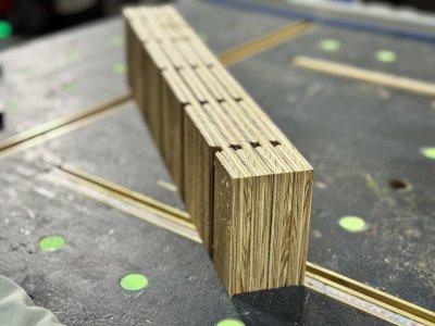

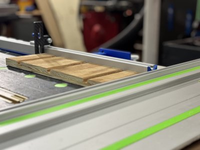

Thank you all, I’ve been working with the setup more and getting a better feel, as well as confidence in it. Lincoln’s rec of relying more on the stops yielded these results this evening.
