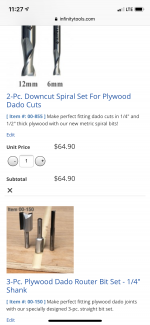

I’m looking to get a MFK.  Looking at Infinity website, which one of these sets would be best to use with MFK?

I like spiral bits.
But its a personal choice really which on you go with
Though I haven’t tried a downcut bit in the MFK, I prefer the upcut spiral bits.  The downcut bits can push the router base up a hair or push the plywood down a little if you’re working off the edge of a table.  Usually I’m going with the grain for cabinet backs and drawer problems so tear out hasn’t been an issue with the upcut bits.
Thats interesting [member=21249]RKA[/member] because I have read the opposite that downcut bits make cleaner dados. Might buy one and try.
The theory is sound, with a down cut, the shearing action pushes the face veneer into the plywood eliminating tearout.  But when you're moving the bit in the direction of the grain, using a sharp upcut bit it doesn't really produce tearout.  Generally I avoid downcut bits unless a specific situation calls for them.  They require a little more care to use.
