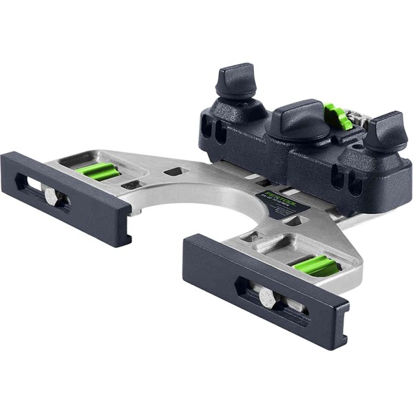

G grellpin Member Joined Nov 28, 2022 Messages 7 Apr 13, 2024 #1 Hello, I see two fences for the MFK700: 578054 and 495182 It looks like the 57804 is maybe an older model? Can anyone explain the key differences? I have the MFK700 and the OF1400 - and the OF1400 fence sort of fits but is clearly not ideal. Thanks!
neeleman Member Joined Jan 2, 2010 Messages 1,316 Apr 13, 2024 #2 Model 578054 is the latest model. The side plates can be adjusted without tools by just turning the green rollers. It also suits the OF 1010 router.
