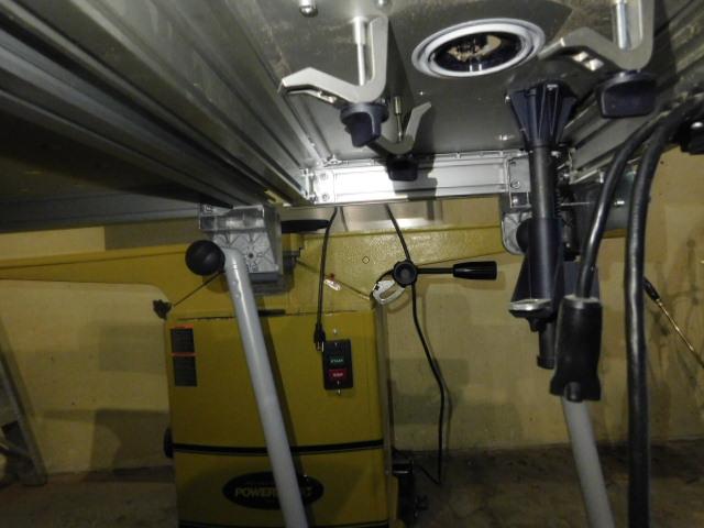

Here ya go!:
These are from VB-CMS/CS50, but exactly the same as VL. (My VL has the router mounted so it was easier to remove this table..)
[attachimg=2]
[attachimg=3]
[attachimg=4]
[attachimg=5]

Are those plastic parts on the bottom are removable? It looks easy enough to use some MDF or ply and fabricate some kind of mount. A couple t-slot type bolts/nuts in the T-track (Like 1/4"x20 toilet bolts) will secure it tight. 2x4's work great for structure. Mounted to the wall would be solid. A couple legs could easily be built to make it free standing.
Petty sure they’re removable, also pretty sure they slide of the track, after unscrewing the bolt that’s adjusting height of the black plastic part that sits in the V groove. Though, I’ve not tried.
Should be fairly easy to adopt to another fabricated ply, MDF or even to another aluminium profile.
