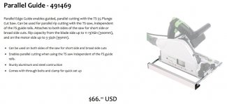

If you intend to make regular use of the bevel feature, one accessory that can help out in combination with the rails is the Parallel Guide:
It can be flipped over and used on the side of the saw to prevent the tipping whereas on one side it is the same thickness as the rail.  It can also help to provide a more outward "handle" versus pressure on the base.  This may help your situation but I primarily mention it because it is an often overlooked benefit for this accessory.
