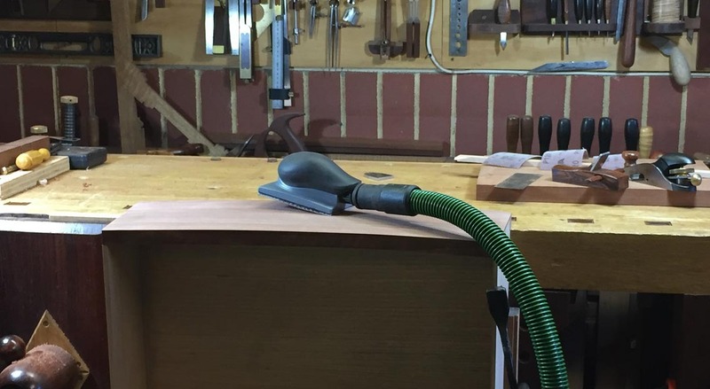

I have the smallest size Mirka hand sander (two of them). That is the value of it to me. Large areas can be done with power (or hand planes, my preference), but small areas of sanding are better with something potentially less invasive. Dust control is important with this hand sander, since it would otherwise throw up much dust.
I use Abranet mesh with these sanders, which facilitates excellent dust control (via a Festool CT26E). At first I used the hand sanders with the 27mm hose ...
This hose is heavy and unbalances the hand sander.
More recently, after exploring hoses for a Mirka Ceros, I obtained the 20mm Mirka hose for the hand sander. It is night-and-day in terms of lightness and flexibility. And cheap. Much recommended!
