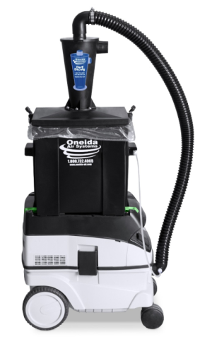

After an issue with my CT 36 EI, I’m looking to switch to either a CT 26 EI or the new CT MIDI I. This will be for a dedicated home workshop setup and will be paired with an Oneida Ultimate Dust Deputy (Festool version), ETSC 2 150 and RTS 400 REQ sanders.

I run the Oneida on a 26 and really like it…ive run it thru an older midi and can’t tell the difference in suction (I think the main difference is the container) the only obvious thing is what I always say is portability …. Midi/Mini much easier to take up a flight of stairs
*I can’t remember, because it lives on the 26 but not sure the Oneida attaches to the smaller vac
The base of the Oneida Ultimate Dust Deputy is the size of a Systainer so it will fit on top of any Festool vac. But it doesn’t secure very well by itself. If you intend to move the setup you’ll want to add a bungee cord or something.
I think it’s been mentioned before that there isn’t much difference in airflow between the various CT vac’s but you can look it up yourself. The main difference is size and therefore volume capacity of the bag. But if you use a cyclone the volume of the bag is no longer a significant factor. So now you have to decide where you want to park the vac to determine the maximum size you want.

At one point, I also took a look at the systainer version of the Oneida. Honestly, I hate the way it looks. It's just ugly and doesn't have the utility of the CT-VA-20 (mainly the ability to stack systainers, which I have found very useful). Once you put the Oneida on, that's it. Nothing else. I guess you could put a classic systainer underneath it to hold stuff, but it would be so cumbersome to access that it's useless.
That said, I have been considering the ugly Oneida for my CT22 as a consignment shop has a used one for under $150.

I mean, it's not "pretty." But it does fit on top of the dust collector. I wish Festool would've fix their cyclone to be as efficient as the Oneida.
I agree. It definitely fits. Well, it fits somewhat. There's a thread on here where they had to modify the Oneida to properly secure on the CT. I don't recall the specifics though.
I just think it's God Awful Ugly and doesn't have the stackable utility of the CT-VA-20 or even the compactness of the Starmix Dustfixx (which is cheaper). But I have no doubt it works. Oneida is excellent in their realm.
I believe the new style 578512 MIDI Will not attach to the Oneida Ultimate Dust Deputy as it appears Festool has deleted the original sustainer latches and is now T-loc only.
The OUDD never fit well on the previous gen of vac’s anyway due to poorly shaped tabs. It is stable enough in a stationary setup but needs help when mobile.
