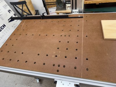

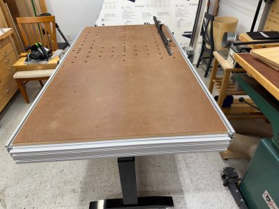

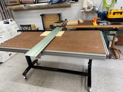

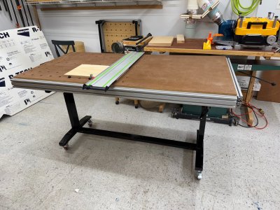

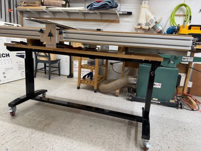

Over the winter I built a few new shop projects. First up was this 3 x 6 foot height adjustable workbench/cutting table/MFT. I used a Husky adjustable height workbench and added a secondary MFT style top over it. It makes a Ron Paulk type storage area underneath. I used 1530 rail from 80/20 and a dashboard rail hinge setup. I am continuing to use the Benchdogs fence that I had from my MFT 1080 since it is a fantastic piece. I used this thing to build some serious shop organization over the last few months and it is better than I had hoped. That Husky table is working great. I'm sure there are some plastic internals, but it's survived some pretty significant slamming around and overloading so far. Battle scars in pics, bet you can guess what caused the elongated oval ones :)
