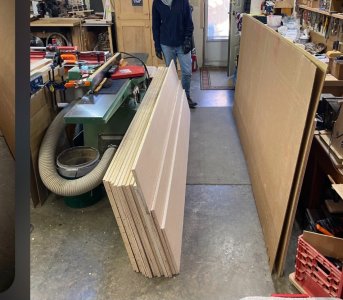

I always get my sheets rough cut to size at the lumber yard. My cabinetmaking friend who runs a business, on the other hand, never gets sheets precut...he does it in his shop on the table saw -- with the help of someone.

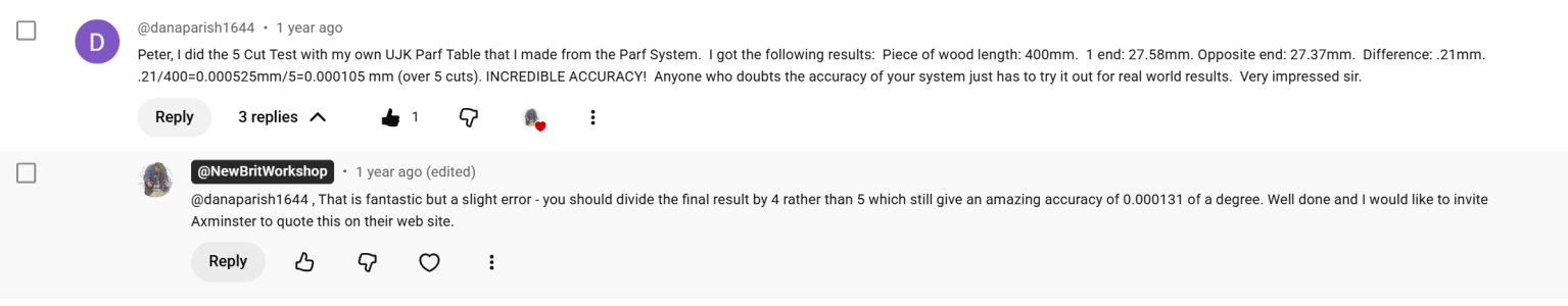

I know that this will look like a bit of advertising on my part but I have a genuine interest in accuracy and spent 2 years working full time on my own to develop the Parf Guide System. My current tracksaw cutting station gives me accuracy on 90 degree cuts of 0.0007 of a degree. Others have done better - ask Ron Paulk or do a Google search. Here is a post from one chap whom I have never met and my only correspondence with him is on this image:
The PGS has even won the prestigious King's Award for Enterprise in the Innovation category (only about 2 awards a year are won in this category).
