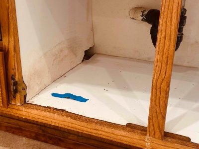

Here's a photo of the area with water damage. It's a face-frame cabinet, as you can see.
It seems to me it might be easier just to remove the left side of the floor and the lower side, rather than replace both entire pieces.
The photo gives me a much better sense of the damage. In this case, I would remove the cabinet and replace the left side and floor with plywood panels as you had suggested, then apply a decent finish. I have a cabinet in my house that is made of particle board, and was installed (before I bought the house) directly on the tile floor. When the prior owners washed the floor, some of the water got into the particle board which is disintegrating. That is where I would use the Azek base to hold the cabinet up out of any wetness.
