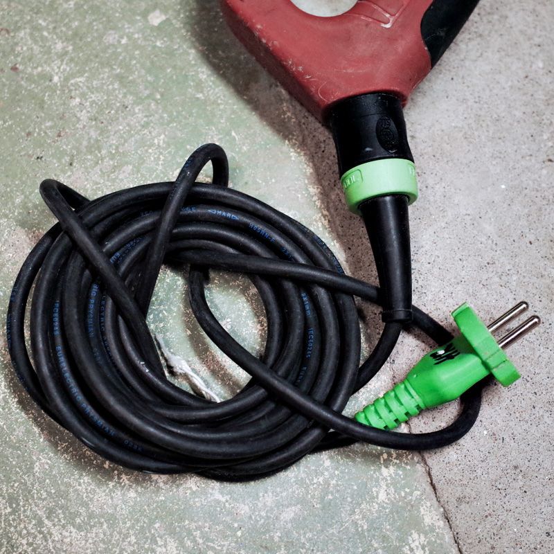

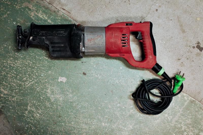

I run the Milwaukee on a Plug It cord, as solid as the original Milwaukee Plug it:
