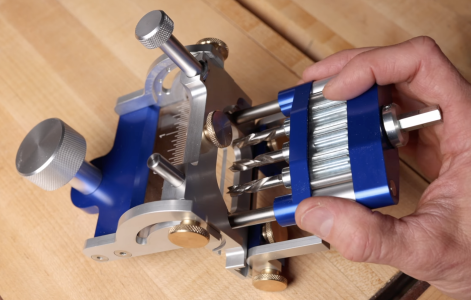

Andrew Klein (maker of the very cool Turbo Vise) has designed a new tool:
It's got 3 drill bits rotating in a domino-style base/fence system. Unlike the Mafell and Triton duo-dowel thingies, this one doesn't have a built-in motor; you attach your drill.
It looks decent - the milling on the fence system seems perhaps better than on the Domino Base/Fence system. Instead of paddles, he's got flip stops with ⅛" increment detents, which gives you more choices and much less wiggle. Unfortunately, depth of drilling is set by how far you mount the drill bits into the device; and although he does have 3 flats machined to different lengths for 3 different depths, that seems a bit unweidly and lacks the fine depth adjustments of the Dominios. No dust collection hookups that I saw. Fence height and angle adjustments look good, although the whole thing seems narrower than the Domino.
But, overall, at $349 (intro price), it seems like a decent "don't want to spend that much on a Domino" dowel guide. How good it actually is, however, will have to wait until they start shipping this December.

Funnily enough I saw that video just a short while ago, at $349USD which for the build quality isn't bad at all I would think. Nice looking unit.
I do however wonder how well it will perform after a number of holes.
The thing that really surprised me with my DDF40 was how much pressure I needed to apply to the unit to drill the holes.
If you don't have the patience as I didn't (I fast-fowarded), start the vid at the 6:00 segment.
I certainly wish the inventor good luck because it may please the dowel users. But like other attempts before it, the killer label is there to attract views. That says a lot about how successful the Domino Joiner has been. Aren't the DF patents expiring soon and will clones be coming to the market to bring down prices?
If they do I have no doubt the case will be that they'll either be the same inferior quality as all of the other joinery clones for a not insignificant percentage of the originals price, or they'll be similar quality to the originals at around the same cost.
No dust extraction. A hard pass.
For those thinking about this, you need a high-speed and strong drill for these. A TPC or no cigar for a good experience. Plus rig a dust extraction somehow.
