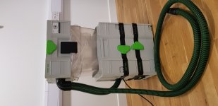

Like this?
Just having  a play.. [big grin]
Have to say it was actually OK!
Big apologies for T-locs.... [embarassed]
Would be very interested to hear just how well it worked with the SYS.
And, if the SYS works then the MIDI will too, surely? Or have I missed something?

Thats what I found when I saw it at Anderson Plywood, Don demonstrated it for me
Hi Oliver
I have finished most of the video shooting and have done a piece about the CTL Sys. Having read Bill Pentz's notes I think that it may be slightly under powered. However, it does separate more than it lets through. I will let someone else do the test though.
What I noticed was that the short hose that comes with the cyclone is the perfect size and fit for the CTL Sys - I do not think that is an accident.
