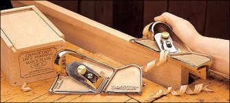

If you do buy the bench unit you'll need a couple of these.
http://static.axminster.co.uk/media/catalog/product/cache/1/image/9df78eab33525d08d6e5fb8d27136e95/1/0/100052_xl.jpg
