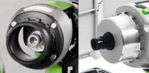

Alright, you really think these two collar designs could even remotely have the same mechanical properties?
As for evidence, there are countless studies into the mechanical properties of structural materials like metals and plastics.
As with all materials, there is a variety of properties to look at. Is it wear resistant, is it impact resistant, can it stand pull forces, can it stand shear forces, can it stand heat or cold, is it resistant to chemicals. What's the weight to strength ratio for given forces?
On some of these properties, some plastics can win over some metals. But if you want a few of these properties combined, metals mostly still win.

It doesn't matter where or on what I plan or do not plan to use the collar, to replace it with plastic for me is a downgrade.
The PDC has a solid piece of aluminum.
It looks like the shaft (to which the Centrotec is attached) now has a plastic support collar.  [sad]
It does matter, because plastic is not automatically worse than aluminium.
Yes it worse, especially on the TPC 18 drill.

Thats exactly what I said: the shaft (to which the Centrotec is attached) and bayonet system now has a plastic support collar, a big downgrade!
On the PDC the shaft soported by one solid piece of aluminum housing!

That's not proof. The fact that two different designs exist doesn't mean you can just insert your own interpretation as to why.
The same mechanical properties? I didn't say plastic and aluminium have the same properties, I just suggested it wasn't worse, or a downgrade.
The mechanical properties of the material simply needs to exceed the requirements. It is not enough to say "plastic isn't as strong", you need to show that it isn't strong enough for this application. So far, I'm not seeing you do that.

Well, we'll see over time how this holds up. The tool is brand new. Plenty of time to hear all the ins and outs of this drill, its good points, and its bad points. I'm sure the Festool engineers have done their calculations and their test to see how it holds up in their lab tests, and now it is time to find out how it holds up in real life.
But one thing to consider for a high end luxury brand like Festool, if you want people to pay for the bling, you need to show some of the bling, which means, do not go down the plastic Home Depot route.
To me, considering it has to accept attachments from two sides, that flimsy ring of plastic, hardly 2 mm thick, doesn't seem to be up to the job, and would prefer to see hardened steel like on the Ti15. But who am I.  [tongue]

But the whole point is that WE DO NOT KNOW if the new TPC/TDC composite plastic-surfaced collar design is more durable than a hypothetical aluminium one would have been. We do not even know if it is good or bad for it being more durable to begin. Being plastic means that if you throw the TPC on concrete and it hits the collar, this can damage the separate collar easier BUT will protect the gearbox from the impact force at the same time while a metal piece will not.
There are simply too many variables to be able to say which technical design is better and from which aspect without having access to the Festool engineer who made the design choice. And even the engineer may not have an answer how the design choice will fare in daily abuse. And this before we start discussing the attachment compatibility aspects even or weight aspects.
But what I do know with authority is that the new design is more expensive to make than the old one was. This comes from the basic fact that a single casting is being replaced with a casting + multiple parts. There is zero possibility of Festool saving money here compared to a PDC/DRC design of the collar. Zero.
I also do know with authority that when used in a drill press/stand one will need to be a bit more careful to not not over-tighten. That is the only known negative until the tools are a few years in the field and we get to see how they hold up.
With "we" you probably mean you, because I can tell you "with authority", even with my limited material knowledge, that a thin aluminium collar will not hold up at all. The collar on the PDC works because it is one solid piece. On the other hand, a thin strip of aluminium is really not very strong at all.
I was more speaking of solid steel, hardened, solid, steel.
The plastic collar as it is would most certainly be better than aluminium.
I think throwing it on the ground won't be the main concern here, but wear and tear of the collar itself.

The PDC + angle Chuck setup is def more robust than the C/T series. But saying that I’ve never had cause to question whether the T/C series implementation is tough enough. It is.
Is the aluminium collar of the PDC tougher than the new TPC plastic one? You’d assume so, in all aspects other than ‘dent-ability’ when dropped. Is the new plastic version probably tough enough for use? I’ll give festool the credit and assume it is, but time will tell.
