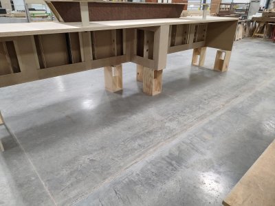

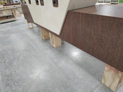

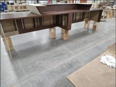

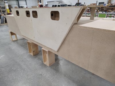

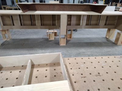

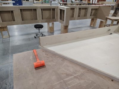

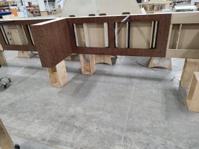

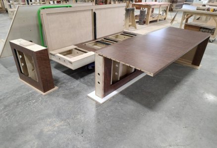

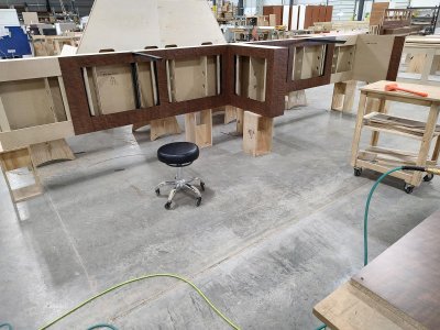

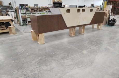

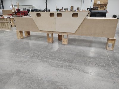

That big concave radius desk just barely hit the floor......and it's gone. I left it assembled for a while, so the Solid Surface guys could test fit the last of the parts. I had already moved on to the next one. It's a little smaller, but kind of unique. The main front face is two pieces, split in the middle, pretty normal. The inside has a center support, that covers the joint, then there is a wedge-shaped cap. It will get covered with quartz.
The holes in the front are just access, to attach the cap, and will be covered when the quartz is installed. I don't normally get this far in the assembly without applying the laminate, but the cap needs to be in place for the stone guys to laser it on Monday morning. I'll end up backtracking, but that's how it goes sometimes.

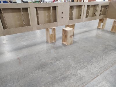

Added inside pic of sides
