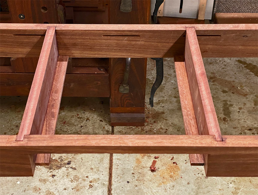

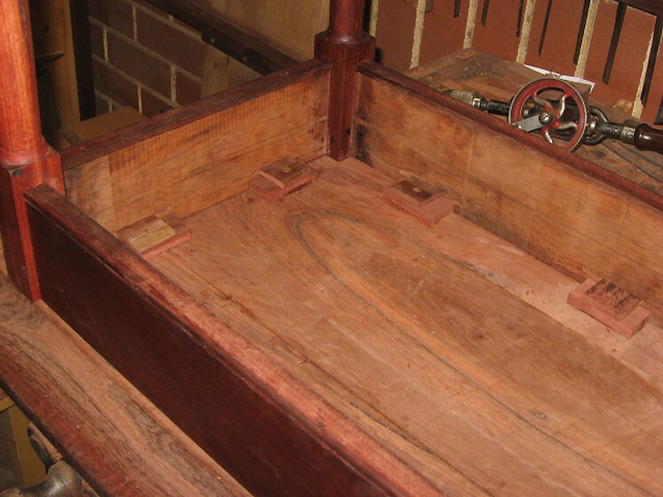

The most traditional method is to use wooden buttons into a mortice. This was done in a table I built from reclaimed Jarrah ...
I have used a Domino machine to cut mortices, and then made buttons to fit (direction if grain is relevant for strength) ...

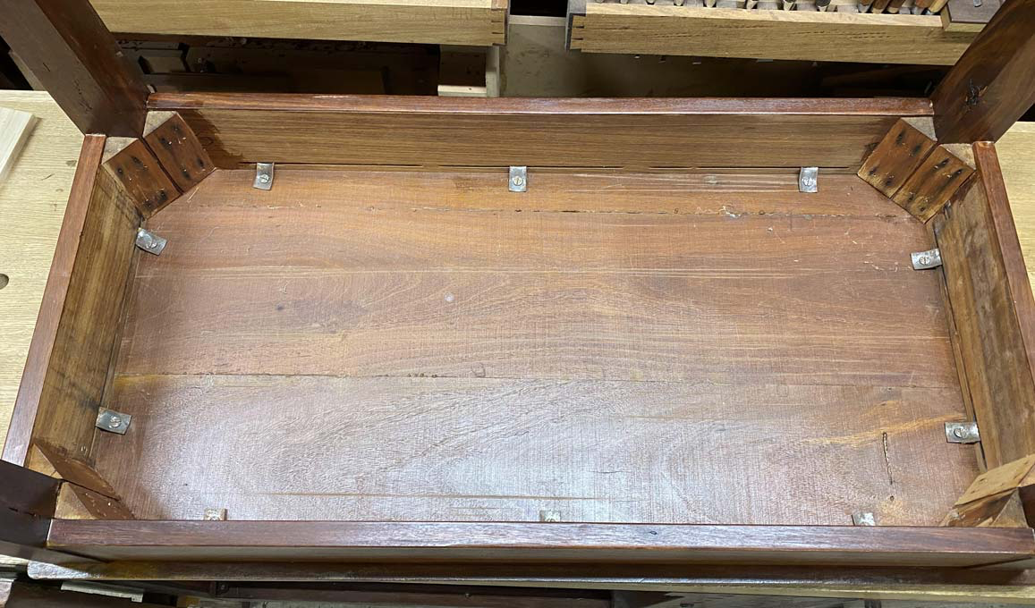

I have also used a biscuit joiner to make the slots ..

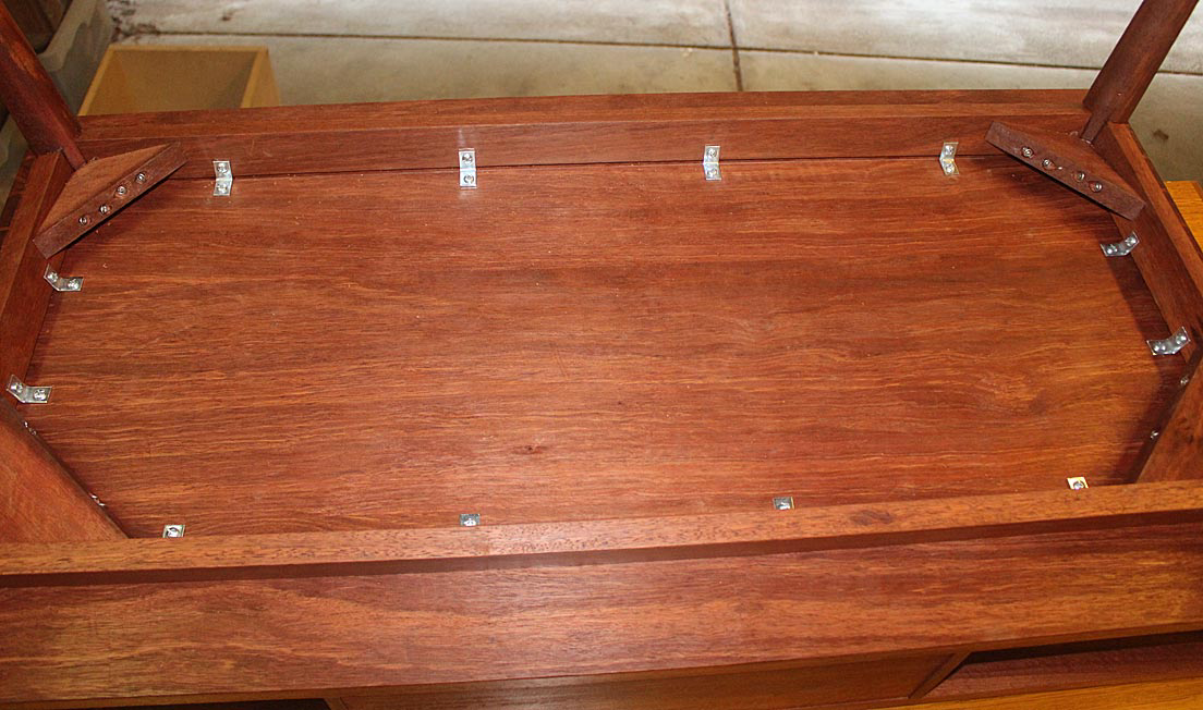

... in this case, re-using metal clips from a table that I salvaged for the timber ...

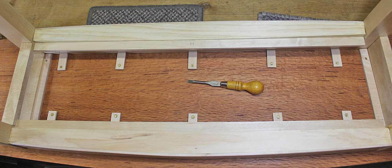

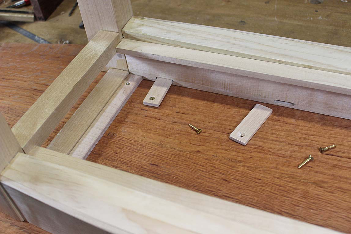

You can make your own metal clips using small angle steel ...
In the last example, it is important to widen the holes on the brackets on one side to allow movement.
