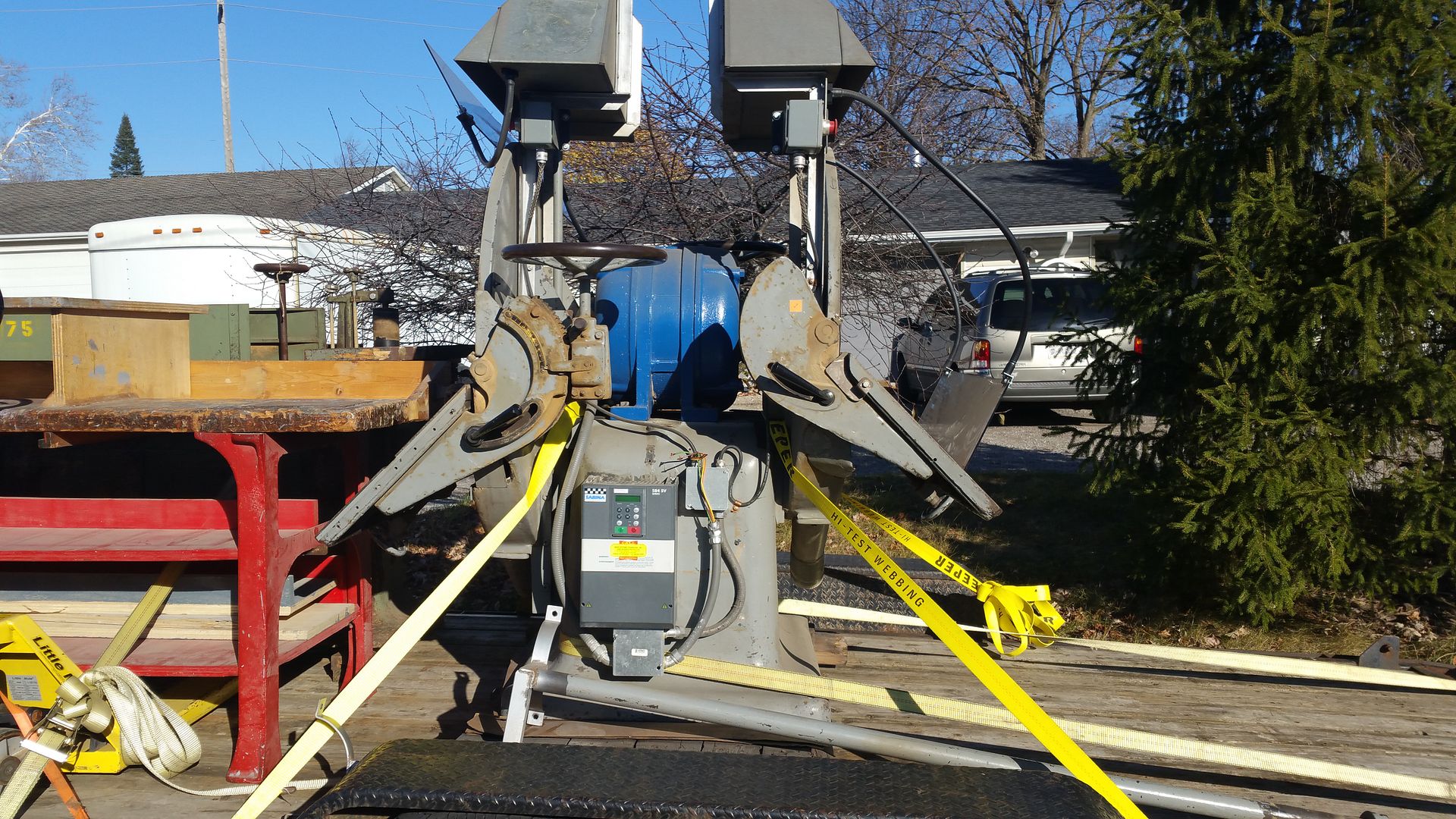

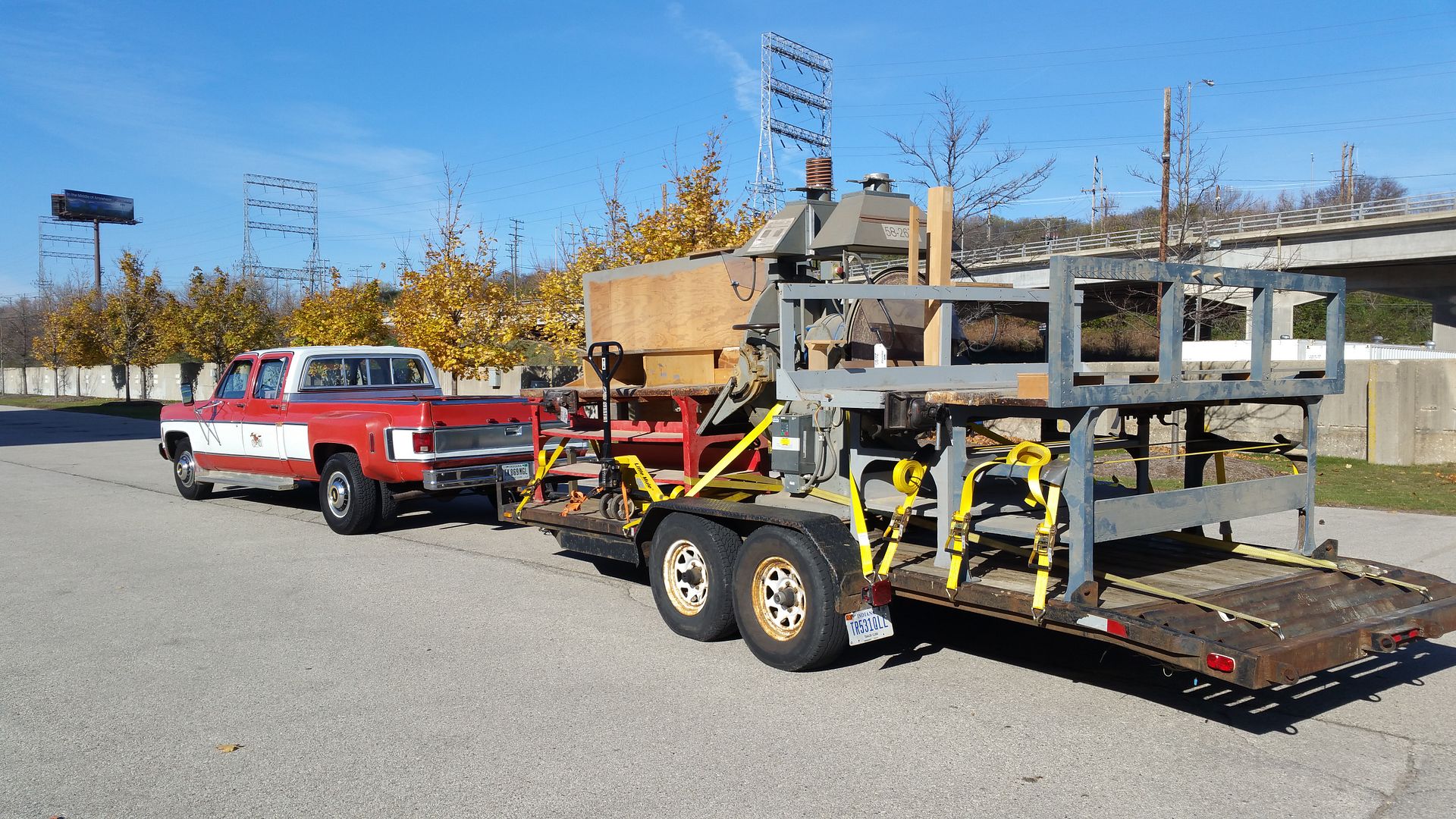

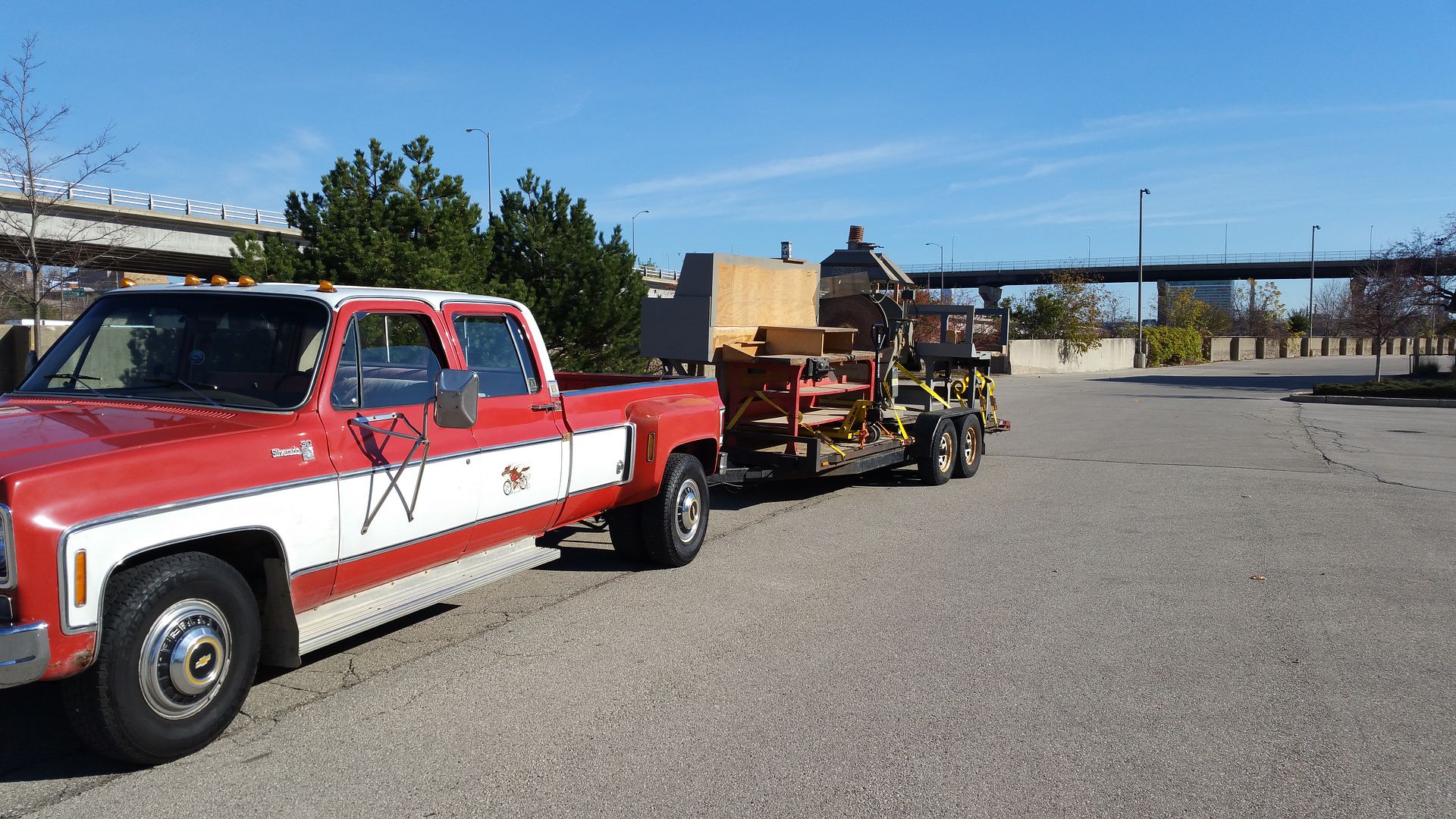

Went on a little drive with a friend to pick up a disc sander and a few pattern maker benches.
Lookin' all Sanford like:
Another 600 miles on the old work horse.
. Haulin' old arn'

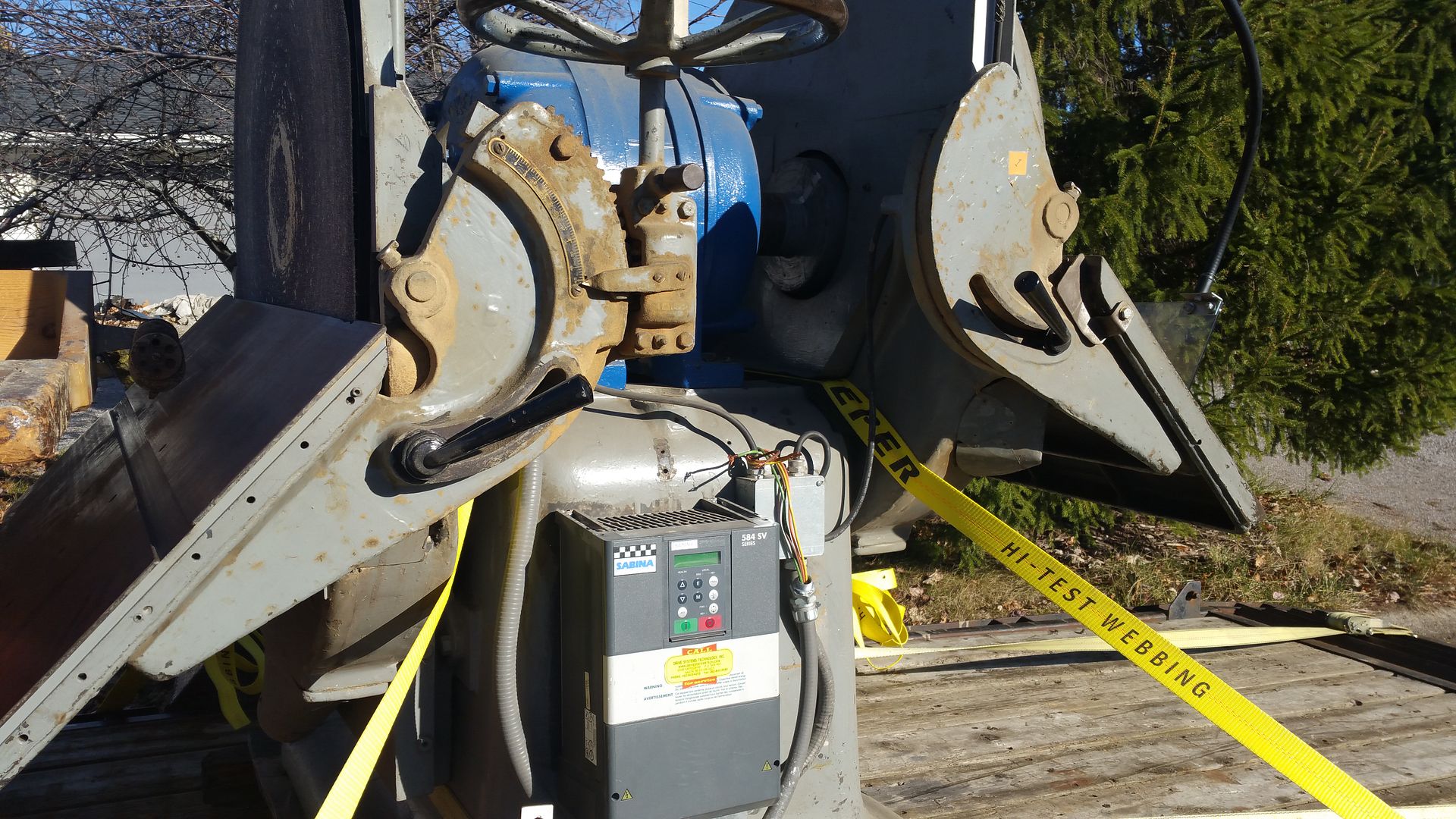

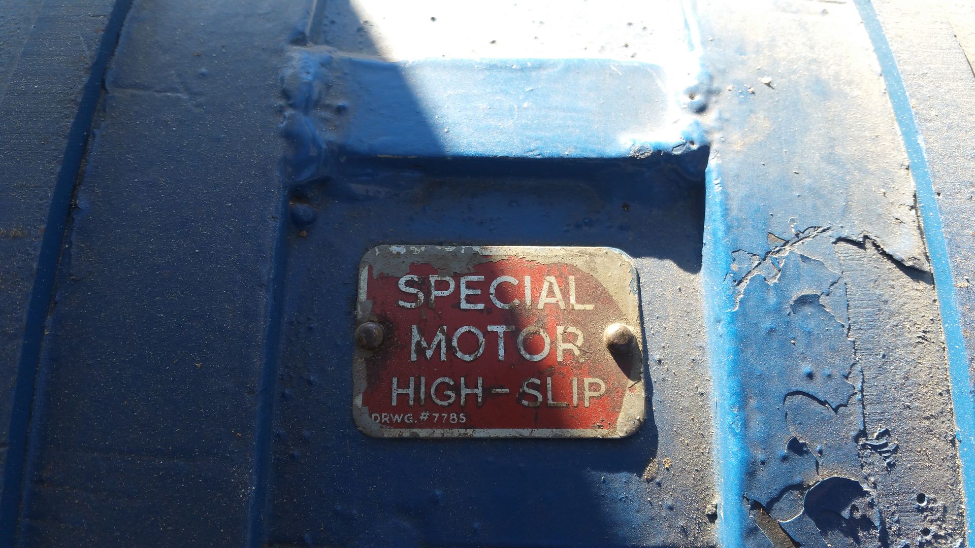

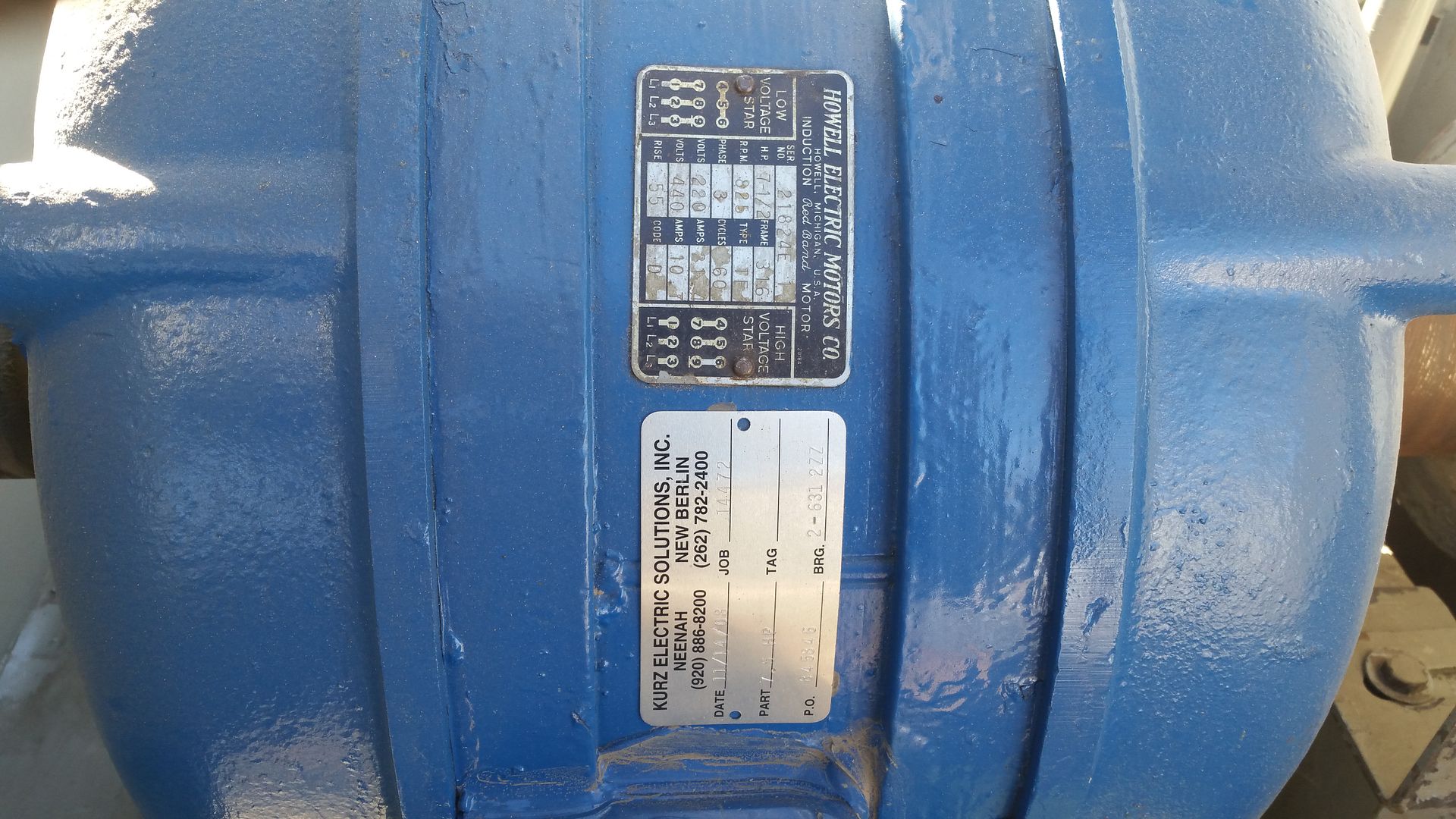

Couple pictures
Says its special.
Looks like I will have to get a transformer for my new shop, if I want to run this with the VFD.  380v-440v it said on the side of the vfd.
