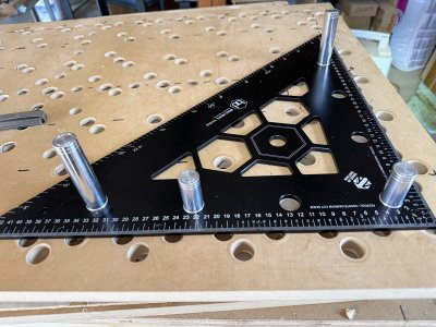

The Parf Guide System has failed me in my little project. It could be operator error, or not. The holes are square in some places and not in others. This is proven by 4 cut attempts and a Benchdog 450mm square. By doing both carpentry and woodworking I need a wider and longer MFT. The systems of Festool, Benchdog, and Dashboard linking tables look great but they are out of my budget.

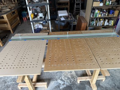

My setup is a pair of sawhorses. A pair of torsion boxes 8' long and about 3" x 4" are set on top of the sawhorses. One, two, or three MFT tops are placed across the torsion boxes in a portrait configuration or two in landscape. On one length of one of the torsion boxes the 1-3 tops are fixed in place with 2 each Smart Connect chamfered dogs from TSO on each top into whatever dog holes I want on the torsion box. I managed to bore 20mm dog holes on 96mm centers down the length of one torsion box with Parf.
I attached three tops to this torsion box, used the other torsion as support and sure enough those tops were aligned as proven by a length of 4545 extrusion and chamfered dogs. Assuming the rest of the grids on the 3 tops were square via Parf I thought I had arrived and only needed to perform a 4 cut test. That's when the rails kinda fell off. The 4 cut was on an MFT sized top and it wasn't square. Eventually I checked on the dog holes. They are the problem.
I had bored a lot of offset holes because I'm using Stanton dogs to attach the guide rail. It took some time to check for square on each place a fence/guide rail could be placed. Each place to setup the fence dog and offset Stanton guide rail dog has to have a corresponding square place on the other side of the tops(s). This pretty much stinks.

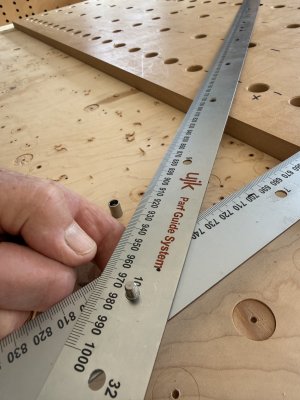

The image of the 3 tops colors are different because one is unwaxed. The following imaging show correct (I think) use of Parf. The Benchdog square is one of the best tools I have. The top with the 'chaotic' pattern is me uber carefully redoing Parf to try determining if I goofed up the process on an already trashed top. A vid showing a feeler gauge indicating .15mm of slop wasn't in the correct format.IMG_0235.jpegIMG_0237.jpeg.IMG_0244.jpeg

For ease of storage I have 3 slabs too. I use Domino tenons for alignment and Domino connectors to hold the slabs as one. For years I had them on two speed horses and TrackTubes. The slabs are attached to the TrackTubes with "stubby" dogs that have bolt heads that can be tightened in the TrackTube top channel. Just this year I splurged and bought a Festool STM 1800 rolling work/cutting table. I love this because I work in my garage and mobility allows me to use my large floor standing tools without the need to take down my big table. I can also roll it outside if needed. I store the slabs on a rack with a cable lift and can setup or breakdown this table in less than 5 minutes.

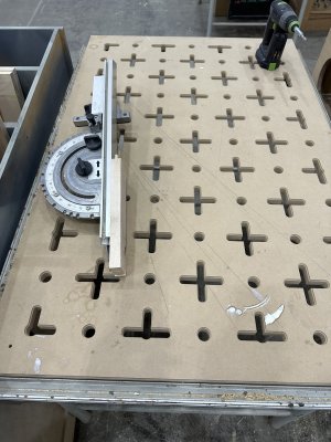

The style of MFT 3 top we designed and use.
All of the benches in the shop have a 96mm grid (which at times can be a pain).
A laser to cut through 3/4 material would need to be much more powerful than my 40 watt unit. We machine the holes with a roughing end mill, then a cleaning end mill. The bits are checked for wear, an offset is entered to make up for the tool wear, random holes are checked to be on size. We have not transitioned diamond bits yet.

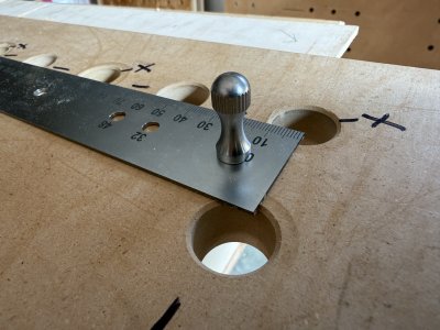

I created an MFT grid on my workbench The Hard Way - by plotting the grid with a ruler and pencil and then drilling the holes by hand (with a CXS12). The grid is not perfect. Most are straight, some are a little off.
But I've been wondering lately just how important a perfect grid is and if it is truly necessary?
If I clamp a track hinge to the edge of the bench and put an adjustable angle fence in the dogholes, I'm reasonably sure I can still square the cut by adjusting the fence angle using a square. Whether it's a fence that's adjustable using the Hongdui Hooked On Wood Fence Dogs from Banggood, or the Festool MFT fence with protractor, either of those will line up the fence to square, right?
As I've thought more about it, I feel that this is correct. Thoughts?

Not intending any criticism but your frustration with the Parf system IS likely down to user error.
My first try with the system delivered a MFT table with 100th of a degree accuracy which surprised the socks off me!
But I totally understand why you want to go the `CNC route and I probably would myself now, too. Why? because it is very easy for human error to slip into the Parf system. I took it very slowly and carefully and was probably more lucky than I deserved with my end result :)
I will need to replace my top next year because - as smorgasbord mentions above, MDF wears out quite quickly. I will probably use the parf system again because I have already bought it but with what I know now and were starting fresh, I would just get one cut by CNC ;)
