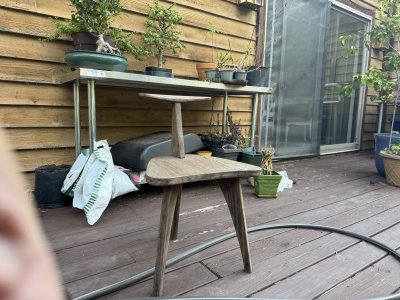

A few months ago, I was able to get a deal on some Thermal Oak. This is a heat treated oak that has properties similar to yakisugi, i.e. weather resistant, insect resistant, and made a chair from it to try. It's designed to be exterior cladding, so the chair has been outside on my deck for most of the summer - exposed to the elements. It's looking a bit weathered but not too bad.
Note: while it looks pretty good, it is a bit finicky to work with. The heat treatment makes it very dry - making the wood brittle so a good dust mask is a must when working with it. All the Titebond III joints failed because it's just too dry (Gorilla Glue to the rescue). It's too dry to take on a finish - I used pure tung oil originally and it turned the wood black and basically sat there for a good month before I scraped it off and left it natural. If you like the look, go for it - but I think it's a bit of a PITA for furniture making.
