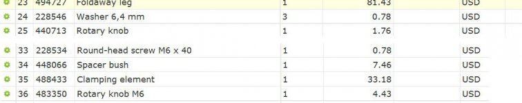

Looks like you're missing parts 24, 33, 34 and 36. With the numbers in the table below you can order them from a dealer or directly from Festool.

Thanks for taking the time to answer my question Alex. That helps a bunch.
[attachimg=2]
Replacement parts ordered.  Thanks for help with part numbers etc.
